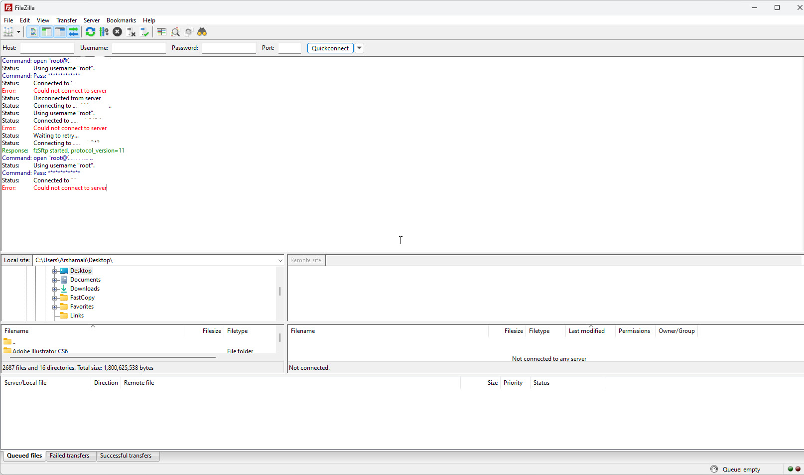

but when im using Sftp (FileZilla) im getting error
Error: Could not connect to server
pls help to fix it

It’s strange that you don’t have the Subsystem directive.
Show all the contents of the file.
grep -Ev '^#|^$' /etc/ssh/sshd_config

Use these commands to fix it.
sed -i 's/internal-sftp-server/internal-sftp/' /etc/ssh/sshd_config
systemctl restart ssh
Working thanks ! where is the error from ? because i just made a clean install following the installation script…
worked thank you sir
It’s a bug that will be fixed in next release.
