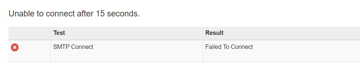

My emails are working fine. All emails are authenticated and no issues with anything.
But when I check my email server at Network Tools: DNS,IP,Email I get
SMTP Connect Failed To Connect

So there are no errors because I have no problem sending emails. All emails are going through.
I run one vestacp server and one hestiacp server.
I have multiple client domains and those domains when sending out emails do not use the default server IP instead they use additional IPs that are chosen at random via a perl script. All IP’s are defined in this Perl script file.
When sending out emails, HELO, and RDNS all look good.
I am curious as to why the SMTP connection shows as failed to connect although there are no issues while sending emails. This is when I check “mail.example.com” for all the different domains hosted here.
The domain’s nameservers point to my hestiacp server nameservers.
However, when I check the same domains hosted on Vestacp those are connected without any errors.

By turning off the firewall the connection was OK.
It looks like the firewall blocks MXtoolbox Ip’s.
