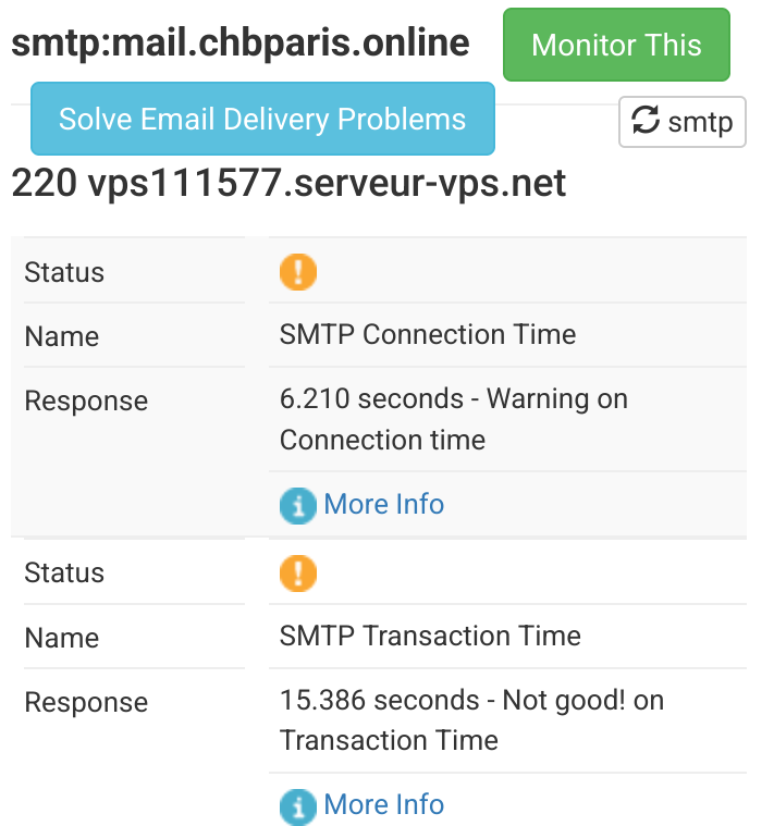

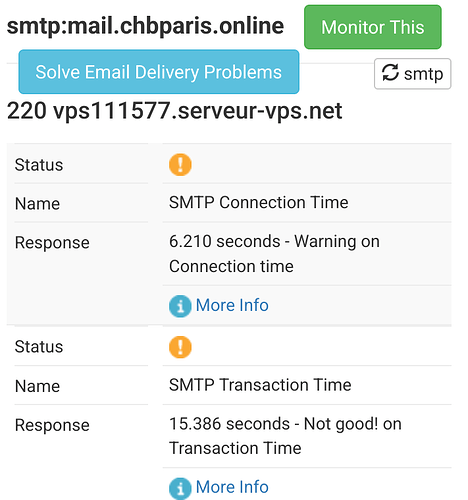

Following a test on Mxtoolbox of my SMTP server, it appears that the SMTP transaction time is really long.
Here are the details :
SMTP Transaction Time :
6.173 seconds - Warning on Transaction Time
Is the problem that it’s a test that is detected as spam or is it the server ?

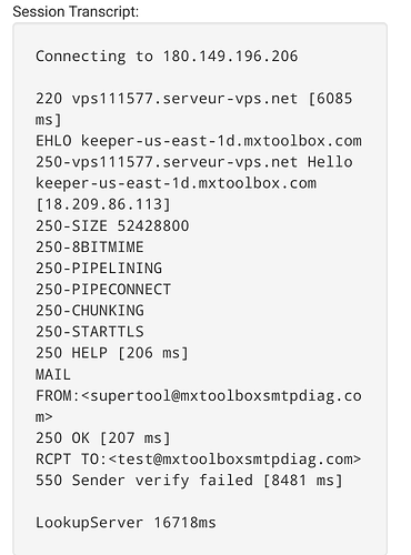

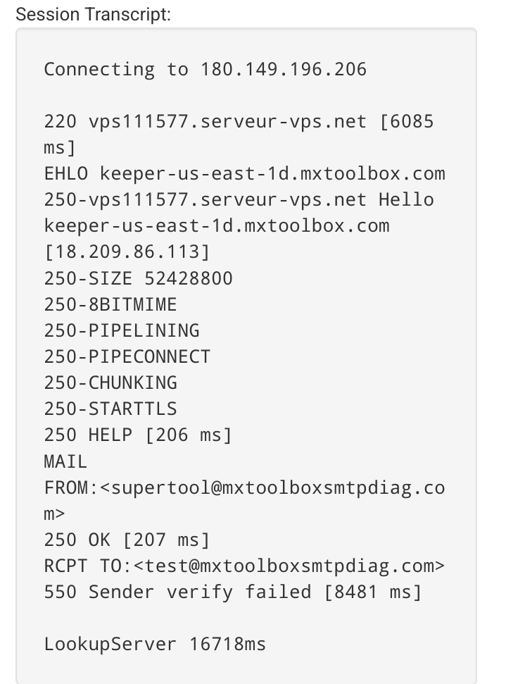

Show the Session Transcript.
Hello @sahsanu,
Below is the session:
And the test result:

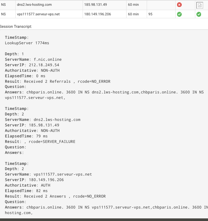

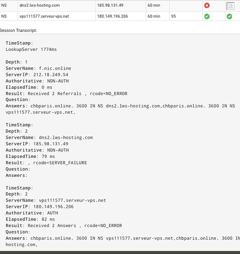

Looks like a slow dns resolution on your server’s side.
dig -x 142.251.173.109 +noall +stat +ans
dig -x 74.125.206.26 +noall +stat +ans
dig -x 1.2.3.4 +noall +stat +ans
dig mx gmail.com +noall +stat +ans
dig mx mxtoolbox.com +noall +stat +ans
I have this result for my name servers:
I’m not asking for that data but as you posted it, you should fix your dns resolution, dns2.lws-hosting.com is not able to resolve your domain.
