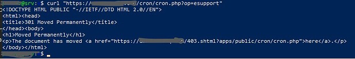

I didn’t think before to run curl through ssh. Previously I tested by accessing the url directly via browser and it worked normally (hits/logs recorded).
But when I run curl through ssh, it shows 301 Moved Permanently.

Use option -L in curl to follow redirections.
curl -L "https..."

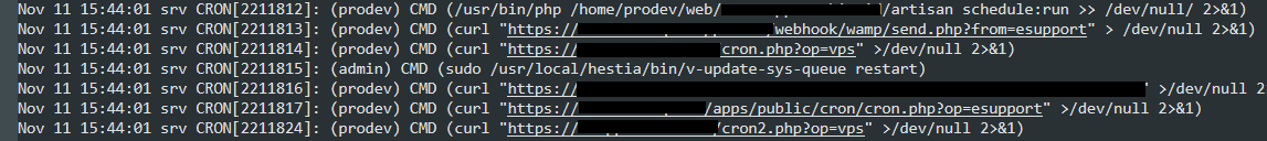

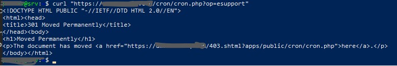

After I investigated, the 301 Moved Permanently seemed to be due to the security module feature on my website which considered it a bad bot. After I disabled the module, I tried curl via ssh and it ran normally. But the cronjob didn’t seem to run even though there was a record in the syslog.
I know the cron job isn’t running, because the log of the targeted page doesn’t record a visit from the server (hit). However, when I tried curl from ssh, the log recorded a visit (hit)
Here it shows that there is a cron history, but it doesn’t seem to actually access the target page (there is no log recorded on the target page as when I tried curl via ssh)
Oddly enough, the cron accessing the website on the same server runs normally. (the 3rd line)
