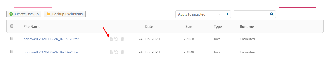

Another issue i’ve notice is when i create backup and try to download the backup
it’s creating another backup request instead of downloading the backup file i’m getting this
Also it’s bypassing the Package limit
for example in Package i’ve set the backup limit to 1 and it’s keep creating a new backup instead of deleting the old backup and creating new one
Will be fixed with this bug fix
