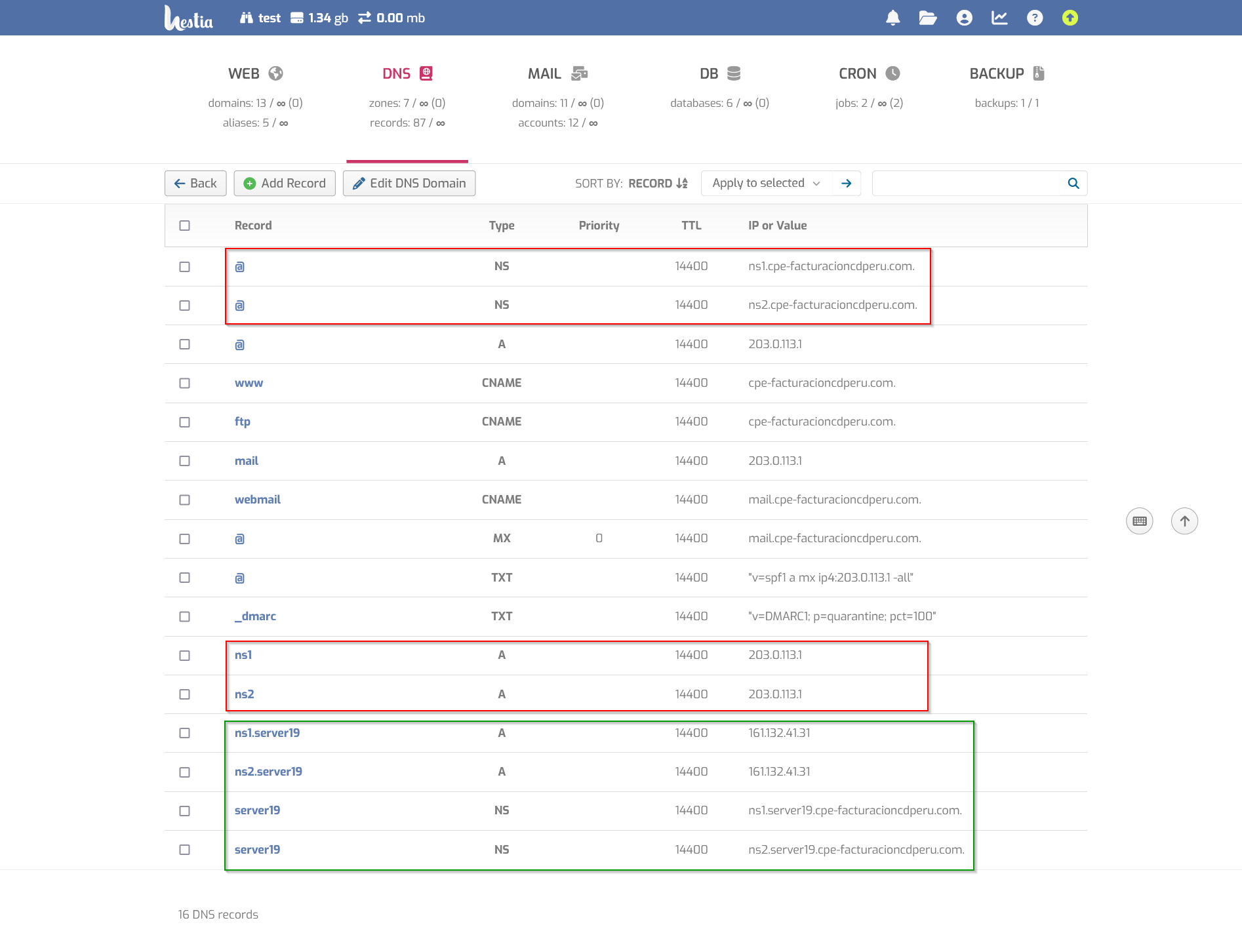

Now, if you want that the other Hestia servers resolve the zones serverX, then you must delegate the serverX subdomains to the others Hestia Servers.
I mean, if you want to delegate server19 to Hestia Server 161.132.41.31, in your main Hestia server, the one where you added the zone for cpe-facturacioncdperu.com you should add these records.
Two NS records for server19.cpe-facturacioncdperu.com pointing to ns1.server19.cpe-facturacioncdperu.com and ns2.server19.cpe-facturacioncdperu.com
And two A records ns1.server19.cpe-facturacioncdperu.com and ns2.server19.cpe-facturacioncdperu.com pointing to 161.132.41.31
Now in server19, you must add a dns zone for server19.cpe-facturacioncdperu.com and again, two NS records pointing to ns1.server19.cpe-facturacioncdperu.com and ns2.server19.cpe-facturacioncdperu.com and also two A records ns1.server19.cpe-facturacioncdperu.com and ns2.server19.cpe-facturacioncdperu.com pointing to 161.132.41.31
I know it can be confusing so here two screenshots with an example for your main domain and the delegation for server19.
Main server:
Delegated DNS Server server19:
