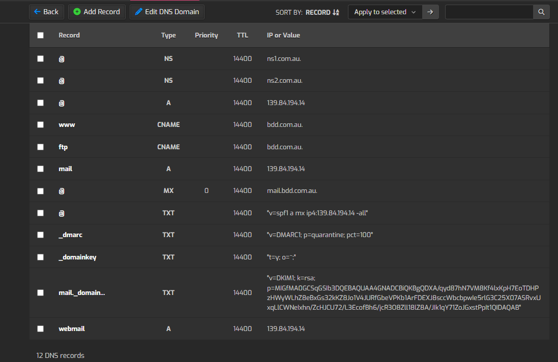

Error: Let’s Encrypt validation status 400 (bdd.com.au). Details: 400:“DNS problem: query timed out looking up A for www.bdd.com.au; no valid AAAA records found for www.bdd.com.au”
If I make a AAAA record and point it to the IP the DNS seems to stop working using dnschecker
If you make a self signed certificate Error: SSL intermediate chain is not valid
DNS is stock standard what Hestia makes when adding a domain
My nameservers are set on my registar
DNS
Anyone have an idea how to get ssl working?

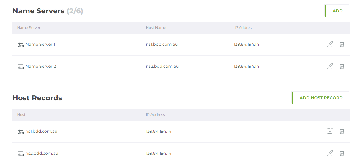

In Hestia you must replace the NS records ns1.com.au and ns2.com.au with
the new ones; ns1.bdd.com.au and ns2.bdd.com.au. You must also add the A records for those new ns subdomains.
Regarding this issue, check this PR:
Thankyou so much for your help. Strange it doesnt put the correct values up in the DNS zone. Pretty sure it used to a few years ago

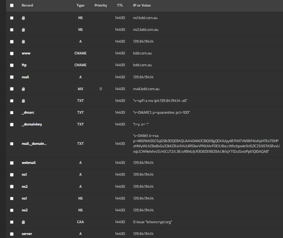

I can see that the NS records have been modified, but there’s no response when querying your server for the A records of your NS servers.
❯ dig @139.84.194.14 bdd.com.au ns +short
ns2.bdd.com.au.
ns1.bdd.com.au.
❯ dig @139.84.194.14 ns1.bdd.com.au a +short
[No output]
❯ dig @139.84.194.14 ns2.bdd.com.au a +short
[No output]
Also, the SOA record still lists ns1.com.au as the primary DNS server instead of ns1.bdd.com.au.
❯ dig @139.84.194.14 bdd.com.au soa +short
ns1.com.au. root.bdd.com.au. 2025100506 7200 3600 1209600 180
Kinda odd

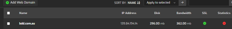

On the bright side ssl is working now

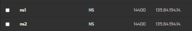

NS records should not point to IPs. These records are wrong, just remove them:
