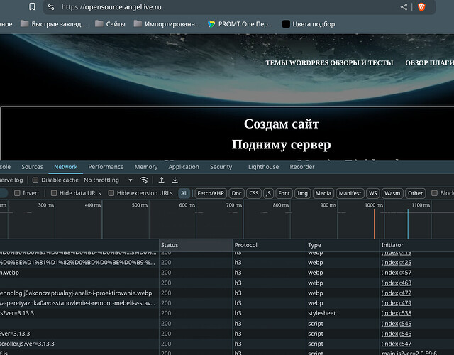

At the same time, all sites gave HTTP 2, and began to give HTTP 3 in the control panel, it is also checked online HTTP/3 Check - handmadeflowers.angellive.ru
HTTP/3 Check - quantumtransition.angellive.ru
HTTP/3 Check - opensource.angellive.ru
You get http3 because you are using Cloudflare as proxy and the http3 is provided by Cloudflare.
But you are not even using quic in your nginx conf.
Show the listen directives please:
grep -Ri 'listen' /etc/nginx/conf.d/domains/*angellive.ru*
/etc/nginx/conf.d/domains/angellive.ru.conf:    listen      203.0.113.160:80;
/etc/nginx/conf.d/domains/angellive.ru.ssl.conf:        listen      203.0.113.160:443 ssl;
/etc/nginx/conf.d/domains/handmadeflowers.angellive.ru.conf:    listen      203.0.113.160:80;
/etc/nginx/conf.d/domains/handmadeflowers.angellive.ru.ssl.conf:        listen      203.0.113.160:443 ssl;
/etc/nginx/conf.d/domains/hestia.angellive.ru.conf:     listen      203.0.113.160:80;
/etc/nginx/conf.d/domains/hestia.angellive.ru.ssl.conf: listen      203.0.113.160:443 ssl;
/etc/nginx/conf.d/domains/opensource.angellive.ru.conf: listen      203.0.113.160:80;
/etc/nginx/conf.d/domains/opensource.angellive.ru.ssl.conf:     listen      203.0.113.160:443 ssl;
/etc/nginx/conf.d/domains/quantumtransition.angellive.ru.conf:  listen      203.0.113.160:80;
/etc/nginx/conf.d/domains/quantumtransition.angellive.ru.ssl.conf:      listen      203.0.113.160:443 ssl;
But before I upgraded the configuration it was HTTP 2, this is the IP of my VDS
I’ve edited your post to replace the real ip by 203.0.113.160.
Well, you didn’t apply your wordpress template to your sites and that is the reason you see no errors regarding duplicated listen directives using reuseport.
Now I’ve just changed the template to WordPress, and again I see http3, apparently you’re right, CF does it itself. To apply the template, I use

    listen      %ip%:%web_ssl_port% ssl;
    listen      %ip%:%web_ssl_port% quic reuseport;
    listen      [::]:%web_ssl_port% ssl ;
    listen      [::]:%web_ssl_port% quic reuseport;
And do others?
server {
    listen      %ip%:%web_ssl_port% quic;
    listen      [::]:%web_ssl_port% ssl;
    listen      [::]:%web_ssl_port% quic;
You can create two templates, one using reuseport and assign it to only one web site and the other one without reuseport to the other web sites.
But if you rebuilt all your users, that has no sense, the nginx conf should be updated.
ls -l /usr/local/hestia/data/templates/web/nginx/php-fpm/wordpress*
