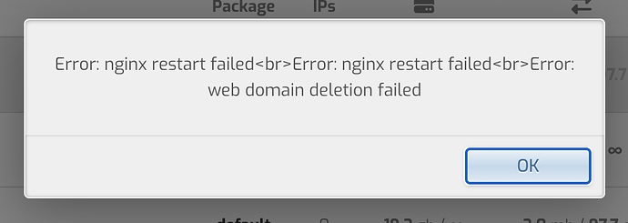

Sytem Error: nginx restart failed

And I get
Max open files            500000               500000               files
and still
nginx: the configuration file /etc/nginx/nginx.conf syntax is ok
nginx: [emerg] open() "/var/log/nginx/domains/webmail.mydomain.cx.log" failed (24: Too many open files)
nginx: configuration file /etc/nginx/nginx.conf test failed
Thanx
