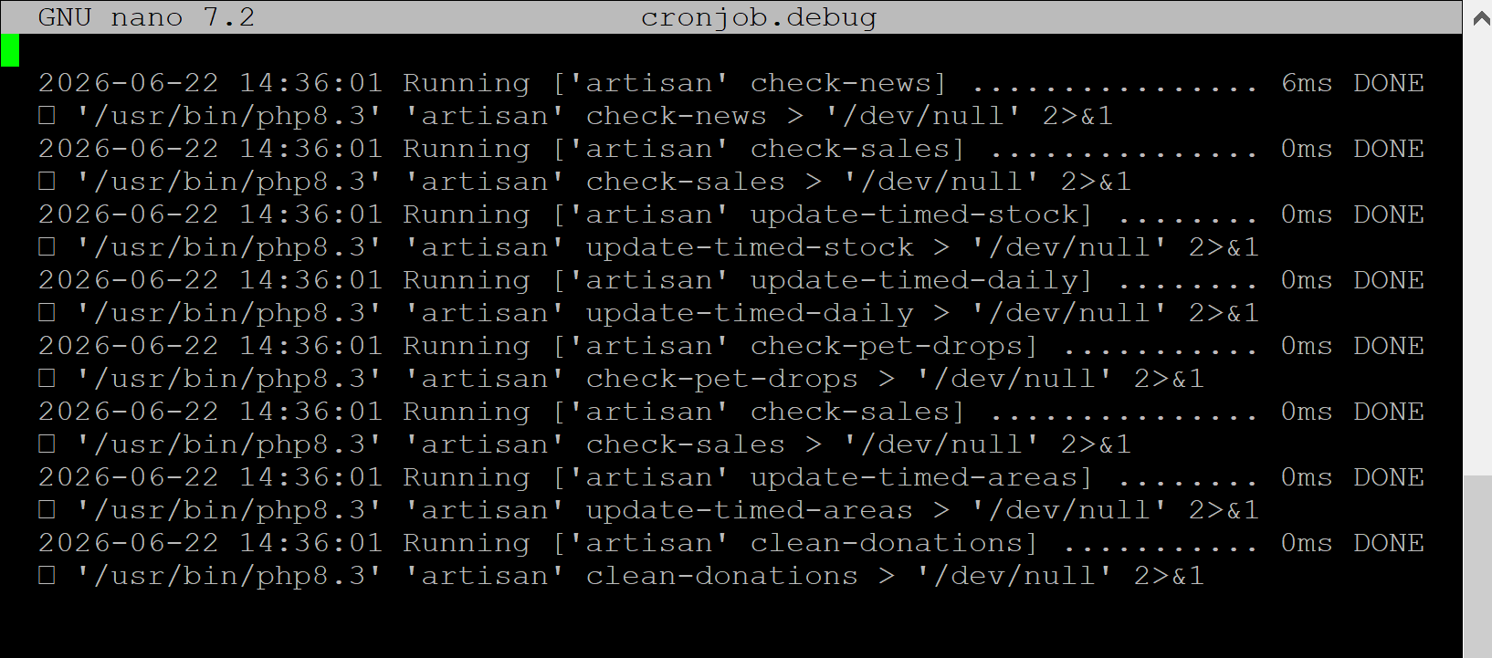

I redirected the output to a file and it looks like it ran fine:
A theory… The specific complaint from the site owner is that tasks that are scheduled to happen ->daily(); aren’t taking place. I know that Laravel’s daily() will strictly only run in a cron job that was started at 00:00:xx.
