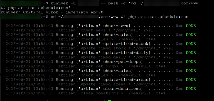

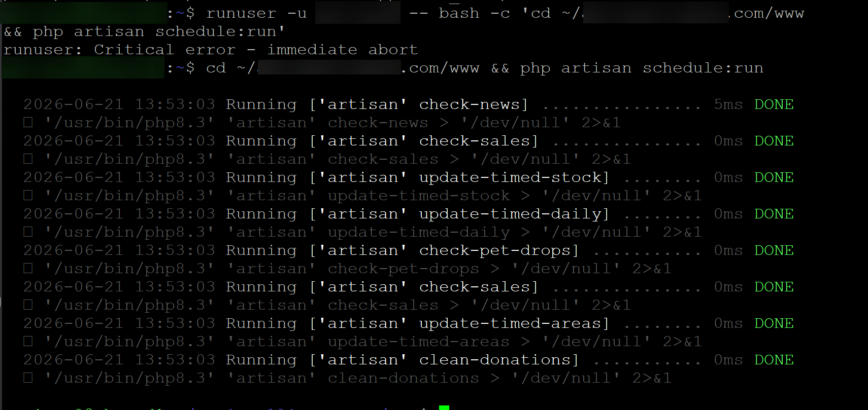

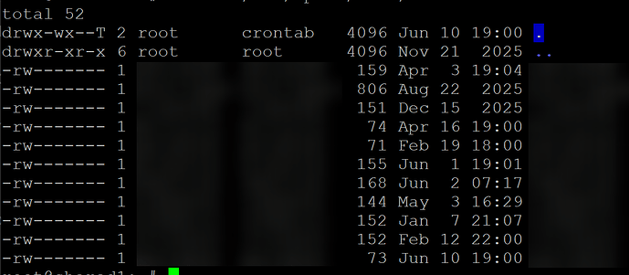

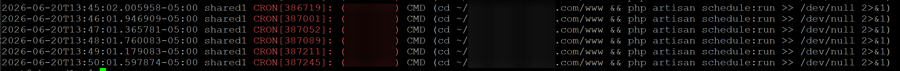

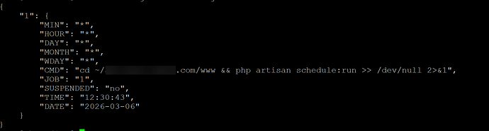

  • Tried increasing php-fpm settings for the site with a custom template (didn’t change anything)

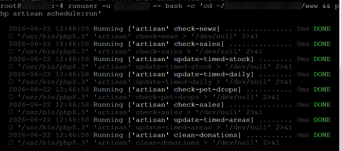

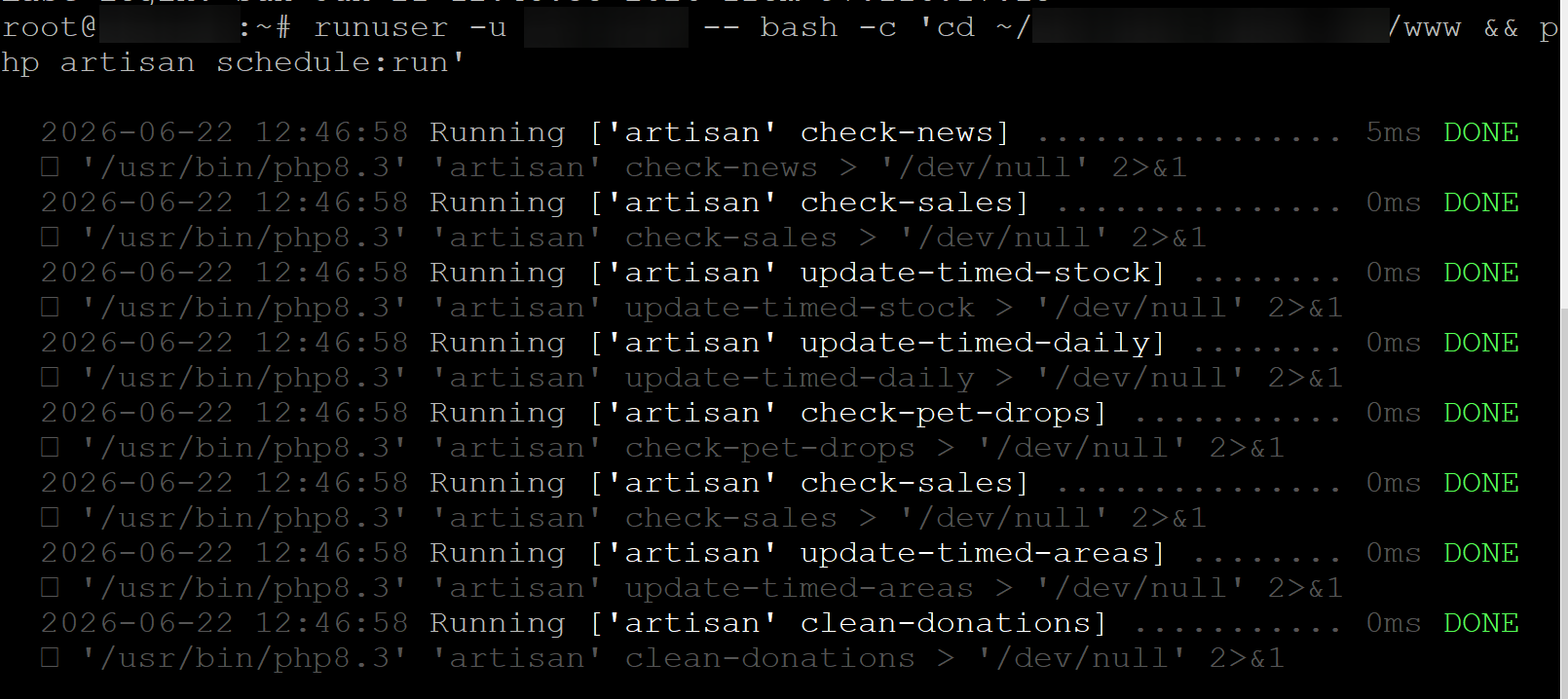

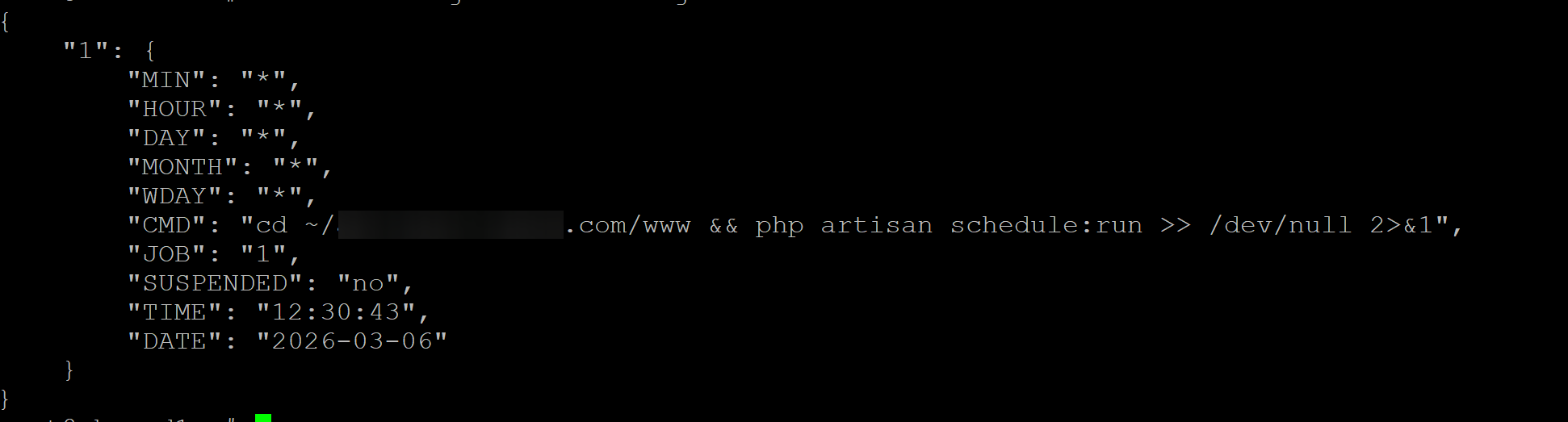

  • Checked for any long-running scripts, like a broken php artisan schedule:run or w/e (didn’t see anything)

For the first command, I do see the user’s cron job listed (the cd is a symlink to a Laravel site within the public_html folder and has had no issues running until recently):

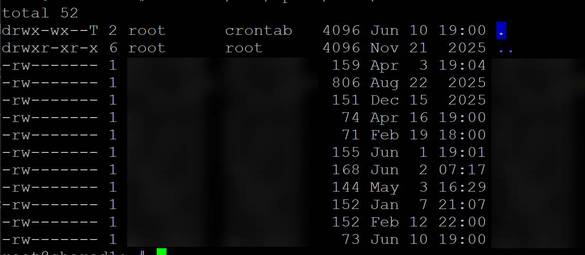

ls -la /var/spool/cron/crontabs shows all of the users, I think this is expected results:
grep 'CRON.*(HereTheUser)' /var/log/syslog results were massive but it did seem to indicate the job is running:
I did try running the schedule:run command outside of the cron and it ran without an error.

It shows that the cron job is running, another matter is whether it is doing what it’s supposed to do.
Are you sure this dir ~/*********.com/www exists? Becasue that doesn’t look like a path used by Hestia.
Please, run this command to know what’s going on (replace HereTheUser with the actual user and *******.com with the domain name):
runuser -u HereTheUser -- bash -c 'cd ~/*******.com/www && php artisan schedule:run'
Ran the command and here’s the result now:

Yes, it definitely exists! Like I said, it’s a symlink into a folder within the user’s web/public_html folder, where the site is actually located. It’s set up for convenience. It was also running fine for the past ~3 months without an issue.
Here’s what’s interesting. Using that runuser command I get Critical error - immediate abort – however, if I run the command as the user outside of the cron job, it’s fine and runs with no errors. So it’s not the command itself that’s wrong or failing.
Perfect, that’s the correct config.
If you can update the scripts on your other server and show the output of iptables -S before updating the scripts and after updating them and running v-update-firewall, I’d appreciate it.
You must run the runuser command as root.

Oh duh LOL sorry about that.
It does work when I run it as root:
Thank you, the script to update the firewall worked as expected :wink:
Then it should work fine from the cron job too.
Could you please modify the cron job to redirect the output to a file? Add this at the end of the command &>>/tmp/cronjob.debug and wait until the cron job runs and then check the file /tmp/cronjob.debug
