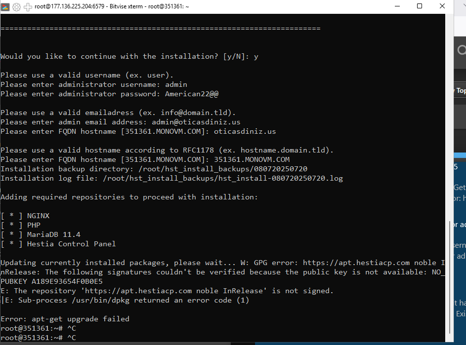

I am facing challenges to install Hestia via bitvise terminal. see the error i’m showing .
Adding required repositories to proceed with installation:
[ * ] NGINX
[ * ] PHP
[ * ] MariaDB 11.4
[ * ] Hestia Control
Panel
Updating currently installed packages, please wait… W: GPG error: https://apt.hestiacp.com noble InRelease: The following signatures couldn’t be verified because the public key is not available: NO_PUBKEY A189E93654F0B0E5
E: The repository ‘https://apt.hestiacp com noble InRelease’ is not signed.
Error: apt-get upgrade failed
