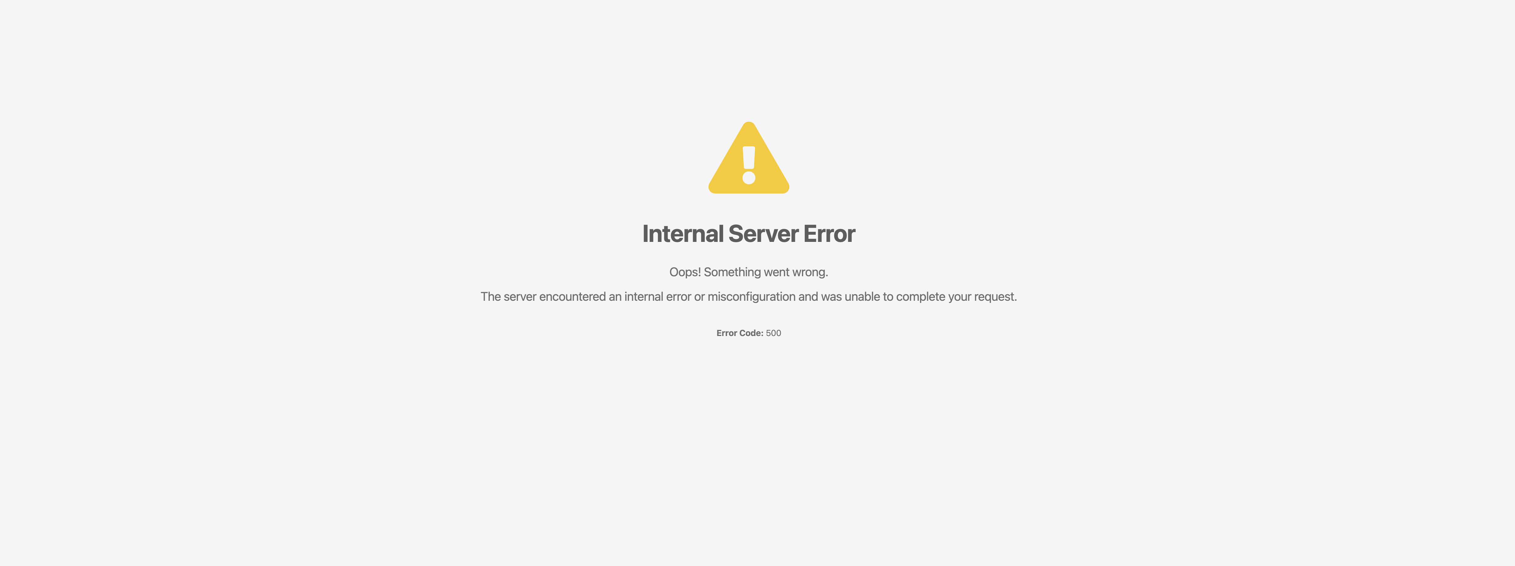

I am getting the below when trying to access PHPMyAdmin.
please need help

If the domain is ba*it.com or nt*re.com then I can see the phpmyadmin login screen.
ooh i see what u mean … i can also see that but I get the error when I click the phpmyadmin button on the DB tab
so i have to use my domains to access the phpmyadmin and not that button?
Try again, I’ve fixed it.
The php-fpm conf file hcp.tu*ge.com.conf was not created inside the pool /etc/php/8.2/fpm/pool.d I’ve just rebuild your site to fix it:
v-rebuild-web-domain admin hcp.tu*ge.com
thank you so much. everything perfect now.
