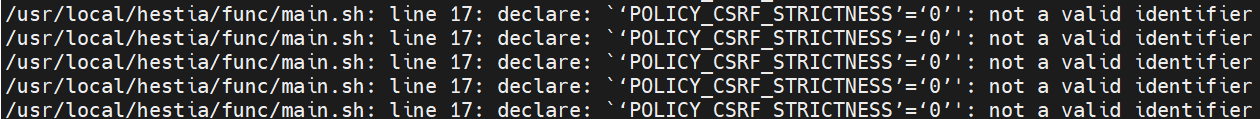

Even rebuild the site using control panel from Hestia. But give me some “error”

Fist step is to fix the error in hestia.conf
Go to /usr/local/hestia/conf/hestia.conf
And check the contents in there
It look like 'POLICY_CSRF_STRICTNESS' has some wrong quotes

I made a mess earlier with POLICY_CSRF_STRICTNESS, but now it’s correct. Thanks!
