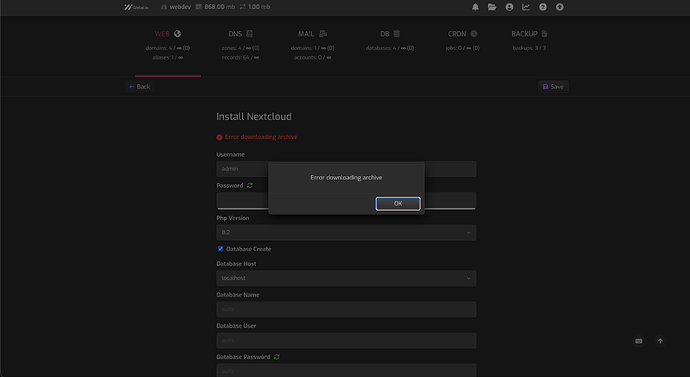

Issue: I tried installing nextcloud on a domain, got error “Error downloading archive”, tried multiple times.

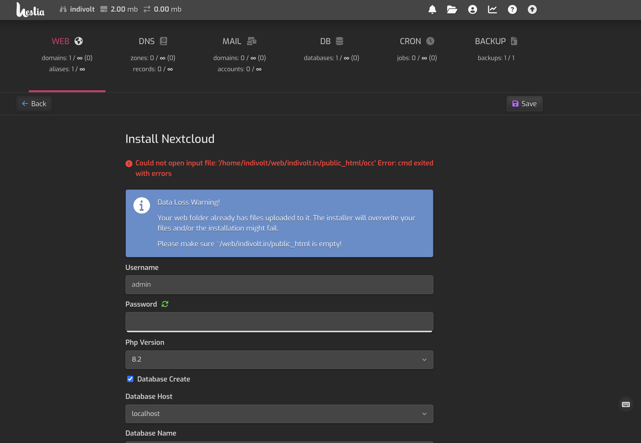

Got a new error “Could not open input file: ‘/home/username/web/domain_name/public_html/occ’ Error: cmd exited with errors”
Refer to below ss.
Update: I checked if it was installed, It is installed indeed on this server even though it showed some error. But still in my previous server, it is not working.
There is currently an issue with Quick Install on HestiaCP with the later versions of Nextcloud. What I’ve found that works is to manually create the database on HestiaCP, copy your credentials and put them in the Nextcloud install instance. Make sure you add the prefix in your Nextcloud instance and not just the database name.
Use this fix:
