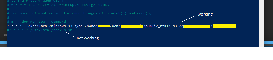

So I’m having trouble running aws s3 sync as a cron job. I did it manually via ssh client and it worked, but it failed when doing it via cron job.
Can anyone help with some direction?
Successfully when did it manually.

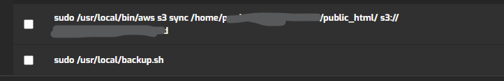

These are not working
You can’t run sudo from admin user any more …
So what should i do? Previously i didn’t use sudo, and it also failed.

using cron
using ssh command
So, the /usr/local/backup.sh is working via ssh, but not working via cron.
Any suggestion?
Probally paths are not correct working use full paths…
It seems the path is correct, because /usr/local/backup.sh works when I run it via terminal, but it fails if run via cron.

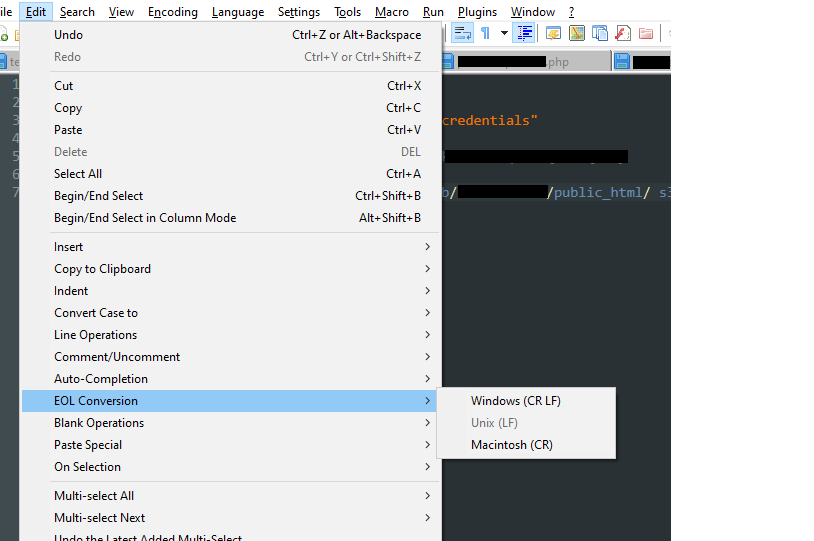

After I googled, the problem is at the “end of file” of the file. I created the file (backup.sh) using Notepad++ on Windows, with CR LF as the line ending (\r\n). But because Unix uses different line endings so it can’t read the file created on Windows.
The solution is to rewrite the script in Unix env using nano or vi (I do not try it). Or edit the file using Notepad++, using the EOL Conversion menu, change it to Unix (LF) (this is what I did).
Thank you very much for your help!
