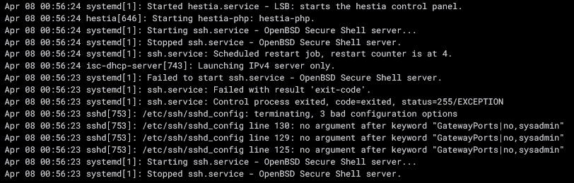

After a while, I noticed that the SSH service was regularly stopping and the configuration was being overwritten.
The cause was that the “sshd_config” file in the #Hestia SFTP Chroot section was being overwritten.
Original:
# Hestia SFTP Chroot
GatewayPorts no
AllowTcpForwarding yes
ClientAliveInterval 0
TCPKeepAlive no
GatewayPorts no
GatewayPorts no
Match user sftp_dummy99
ForceCommand internal-sftp -d /home/%u
Incorrect:
GatewayPorts|no,sysadmin
TCPKeepAlive no
Match User sftp_dummy99,sysadmin
The GatewayPorts|no,sysadmin entry causes the SSH server to fail to start.

Why do you have those GatewayPorts directives in the original conf?
Hestia should respect your port. Show the output of these commands:
for i in /etc/ssh/sshd_config /etc/ssh/sshd_config.d/*; do echo -e "#### Checking $i\n";grep -Ev '^#|^$' "$i"; echo; done
v-list-sys-sshd-port plain

But why do you have GatewayPorts inside the Hestia’s block?
Move the user.conf content to the end of sshd_config again and remove the GatewayPorts directives from that block.
It should look like this (including the comment):
    ChrootDirectory /srv/jail/%u
    X11Forwarding no
    AllowTCPForwarding no
Also remove the suffix -server from Subsystem directive:
Subsystem sftp internal-sftp

No, your conf should look like this:
[Other options]
# override default of no subsystems
    X11Forwarding no
It’s important that you don’t add or modify anything below # Hestia SFTP Chroot. It’s also very important that the Match User directive is placed directly below the comment, with no blank lines between them.
