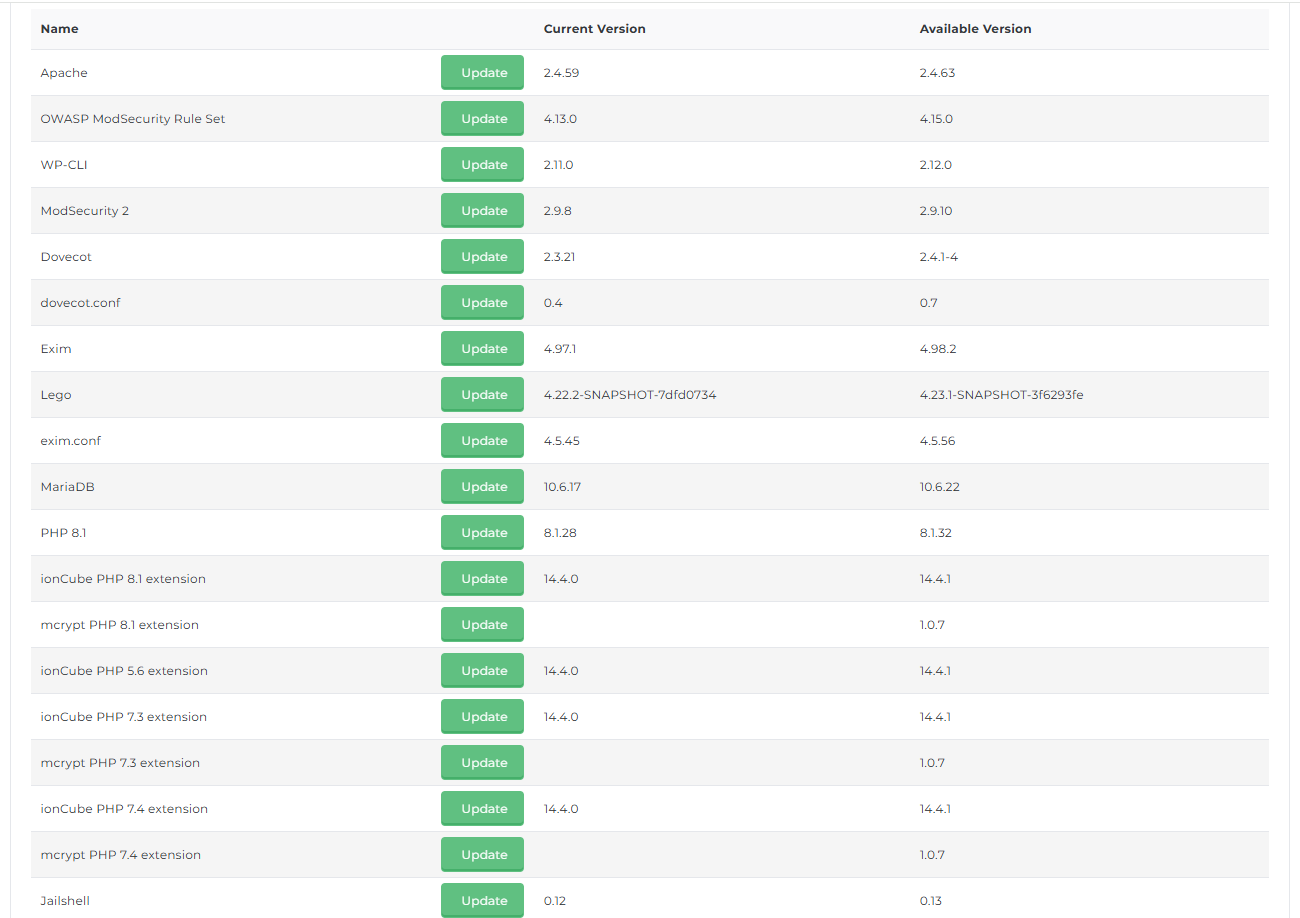

In DirectAdmin I can choose what to update - screen

Ok, so how can I update these software separately ?
Hestia can’t update mysql from panel? Even using any additional plugin?
You can update them using apt. Most of the included packages are updated through the operating system’s utilities.
