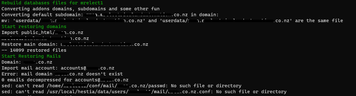

Hi @sahsanu yes they exist, could it be an issue that I have a addon domain also?
I will have a go commenting out those sections of the script and see how I go.
@sahsanu it looks like the script only loads the main domain and ignores the addon domain which causes all my emails on the addon domain fail to imports etc Looks like it restores the main domain but skips the addon domain

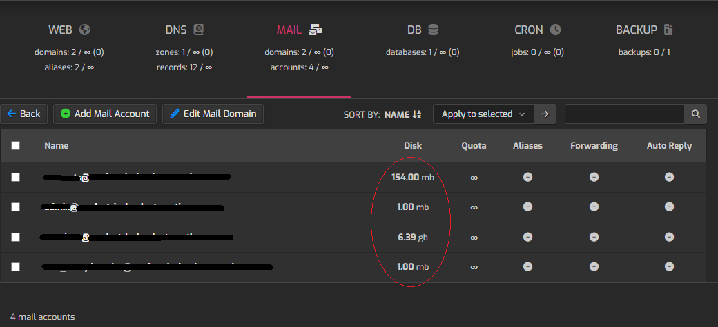

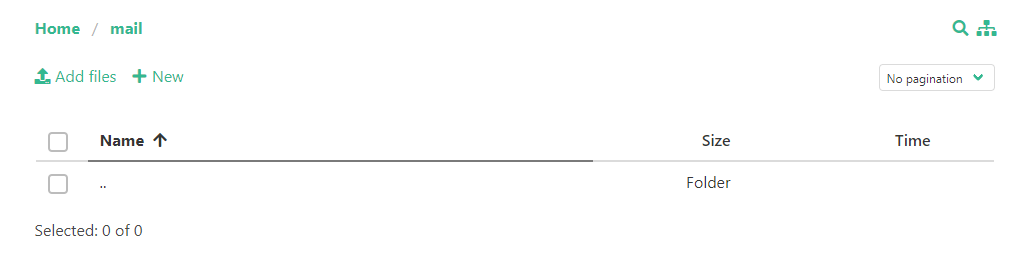

The emails imported on my main domain and show the disk space and accounts but if I go into the mail folder using the file explorer the folder is empty? where does hestia store the emails for that user or domain?
If I ssh directly into my server and look under that user and mail, all the domains are there including all the email accounts for both domains and the mail content etc it seems there may be an issue with the file explorer? Why is hestia not seeing these and adding them to the system?
Ok, it is like add a new domain or sub domain.
mail and conf/{dns,mail,web} dirs are using resticted perms so you won’t be able to look inside from file manager.
Hi @sahsanu since all the contents are there, why is hestia not seeing the email accounts for the other domain, I manually added the domain and enabled mail and all the content is in the mail folder under the correct domain. I rebooted the server just incase and still can’t find those email accounts for that domain, is there another way I need make hestia see them?
Sorry but I don’t understand what you mean. Did you add your web domain and mail domain manually and then imported the backup or you imported your backup and then added manually your web domain and mail domain?
@sahsanu during to original import, it imported all the files for both domains, just didn’t add the second domain to hestia, so I have added the second domain my self manually hoping it would automatically see all the email accounts and files in the Mail folder, but it does not show up in the hestia control panel, they are missing.
if the email accounts were not created during the import, then Hestia will not see them.
