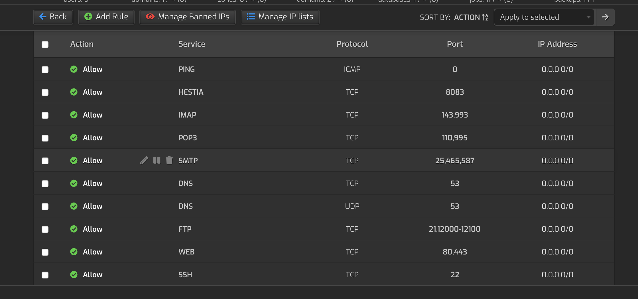

Thanks Eris, I have a very strange error and that’s why I was looking at these commands regarding the fw. On a couple of newly booted machines I can’t ssh in, once I stop iptables in hestiacp I can ssh in, exit ssh again, turn on iptables and now I can ssh in. I don’t understand anything, it’s as if some rule is wrong and it only activates correctly when I stop and start iptables. What could it be?
Is the correct port open in the firewall settings?
I think I know what’s going on, these machines were mounted with the default ssh port of 22, and then had the port changed to another number after hestiacp was installed (example port 44044) As I see it in “/etc/iptables.rules” there is a part that refers to port 22 and another part that refers to the new port 44044, I imagine that is the problem.
It also strikes me that the date of that file is very old (probably from the day of the installation of hestia) and it is supposed that the changes of the iptables rules should be saving, right?
In any case, maybe “iptables-save > /etc/iptables.rules” could solve the problem? more data, my hestiacp version is v1.5.8
Thank you very much
Edit the rules in the firewall settings page.
After that is done it should work fine.

/usr/local/hestia/data/firewall/rules.conf and then run v-stop-firewall and then v-update-firewall

Updating the filewall rule in the panel should update the ip tables config and after v-update-firewall is run also update the iptables config.
First of all, thank you very much for your support, you are very kind! well, nothing happens, I’ll have to be aware and that’s it, if I found the problem I’d tell you.
In any case, with this file (/usr/local/hestia/data/firewall/rules.conf) I shouldn’t do anything, right? I only see that it is fine and the only thing that I see differently is that my comments are in lowercase, nothing more (and the ssh port -it’s diferent- and a new rule for zabbix -10050-).
Thanks!
