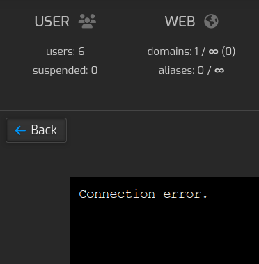

I just wanted to test the new web terminal but I get a “Connection error.” shown - the console says
WebSocket connection to 'wss://cp.mydomain.de:8083/_shell/' failed: webTerminal.js:18
Any further todo to get this new web terminal working?
(also tried adding a new firewall rule for port 8085)

If i try click on terminal icon in hestia panel i got error message “connection error”
Did you check the service and the log?

I’m running tail -f /var/log/hestia/nginx-error.log to view live logs, but when I click the terminal icon in Hestia CP, the error you mentioned doesn’t appear.
2025/06/24 10:23:32 [error] 2985107#0: *842 FastCGI sent in stderr: "PHP message: PHP Warning:  ini_set(): Session ini settings cannot be changed when a session is active in /usr/local/hestia/web/fm/vendor/symfony/http-foundation/Session/Storage/Handler/NativeFileSessionHandler.php on line 53" while reading response header from upstream, client: 60.32.43.1, server: _, request: "GET /fm/?r=/getconfig HTTP/2.0", upstream: "fastcgi://unix:/run/hestia-php.sock:", host: "example.com:38083", referrer: "https://example.com:38083/fm/"
2025/06/24 10:23:32 [error] 2985107#0: *842 FastCGI sent in stderr: "PHP message: PHP Warning:  ini_set(): Session ini settings cannot be changed when a session is active in /usr/local/hestia/web/fm/vendor/symfony/http-foundation/Session/Storage/Handler/NativeFileSessionHandler.php on line 53" while reading response header from upstream, client: 60.32.43.1, server: _, request: "GET /fm/?r=/getuser HTTP/2.0", upstream: "fastcgi://unix:/run/hestia-php.sock:", host: "example.com:38083", referrer: "https://example.com:38083/fm/"
2025/06/24 10:23:32 [error] 2985107#0: *842 FastCGI sent in stderr: "PHP message: PHP Warning:  ini_set(): Session ini settings cannot be changed when a session is active in /usr/local/hestia/web/fm/vendor/symfony/http-foundation/Session/Storage/Handler/NativeFileSessionHandler.php on line 53" while reading response header from upstream, client: 60.32.43.1, server: _, request: "POST /fm/?r=/getdir HTTP/2.0", upstream: "fastcgi://unix:/run/hestia-php.sock:", host: "example.com:38083", referrer: "https://example.com:38083/fm/"
2025/06/24 10:23:37 [error] 2985107#0: *842 FastCGI sent in stderr: "PHP message: PHP Warning:  ini_set(): Session ini settings cannot be changed when a session is active in /usr/local/hestia/web/fm/vendor/symfony/http-foundation/Session/Storage/Handler/NativeFileSessionHandler.php on line 53" while reading response header from upstream, client: 60.32.43.1, server: _, request: "POST /fm/?r=/logout HTTP/2.0", upstream: "fastcgi://unix:/run/hestia-php.sock:", host: "example.com:38083", referrer: "https://example.com:38083/fm/"
2025/06/24 10:23:37 [error] 2985107#0: *842 FastCGI sent in stderr: "PHP message: PHP Warning:  ini_set(): Session ini settings cannot be changed when a session is active in /usr/local/hestia/web/fm/vendor/symfony/http-foundation/Session/Storage/Handler/NativeFileSessionHandler.php on line 53" while reading response header from upstream, client: 60.32.43.1, server: _, request: "GET /fm/?r=/getuser HTTP/2.0", upstream: "fastcgi://unix:/run/hestia-php.sock:", host: "example.com:38083", referrer: "https://example.com:38083/fm/"
2025/06/24 10:23:38 [error] 2985107#0: *842 FastCGI sent in stderr: "PHP message: PHP Warning:  ini_set(): Session ini settings cannot be changed when a session is active in /usr/local/hestia/web/fm/vendor/symfony/http-foundation/Session/Storage/Handler/NativeFileSessionHandler.php on line 53" while reading response header from upstream, client: 60.32.43.1, server: _, request: "POST /fm/?r=/getdir HTTP/2.0", upstream: "fastcgi://unix:/run/hestia-php.sock:", host: "example.com:38083", referrer: "https://example.com:38083/fm/"
That’s is all - last 10 errors.
