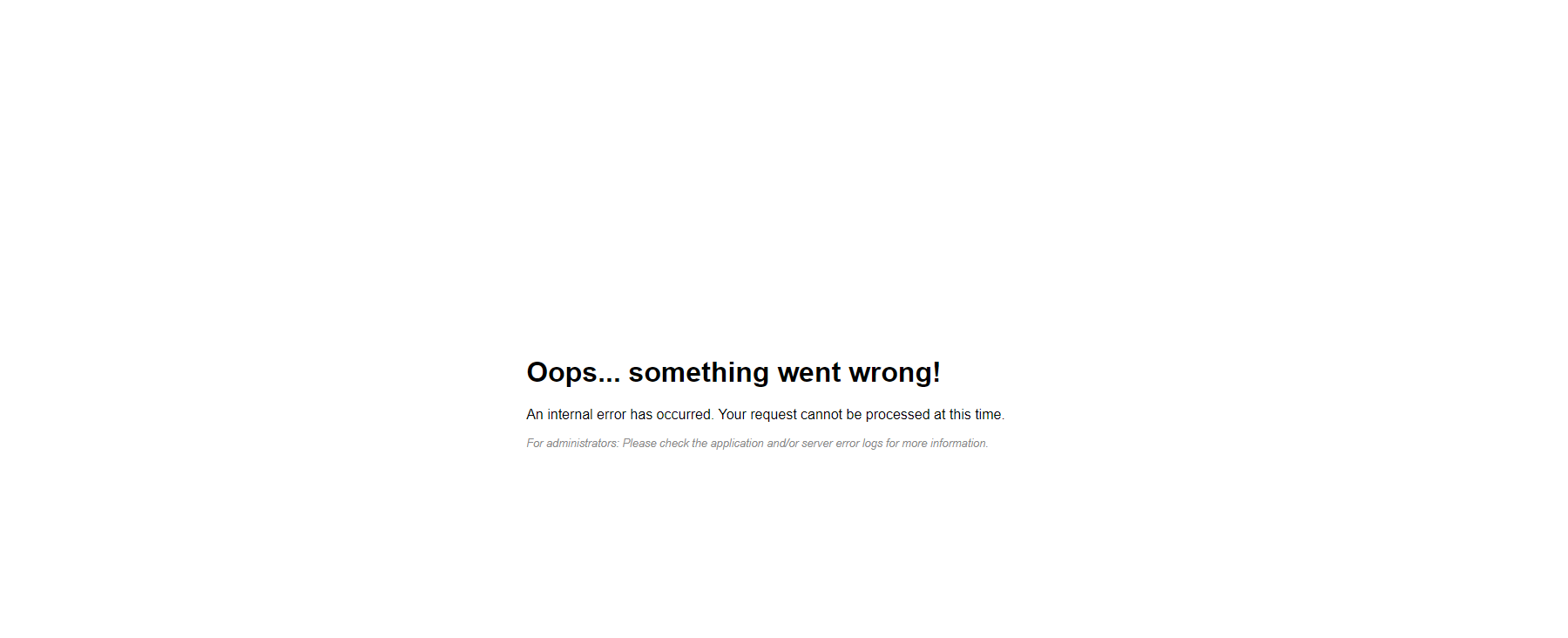

This is what I want to know and tried everything possible. Then, decided to share it here hoping someone might have an idea to overcome this problem as shown in the still image below:
Thanks,
Looks like an DNS issue.
nslookup webmail.domain.com
I was 99% sure of that but I’m 100 now since you concurred it…!
I reset my zones since it was a mess and will return after 24 hrs to set it up again :eyes:
Many thanks bro and always there to rescue :game_die:
