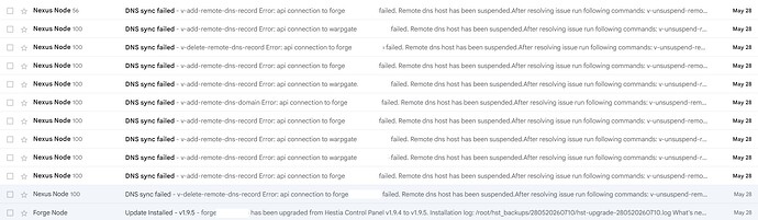

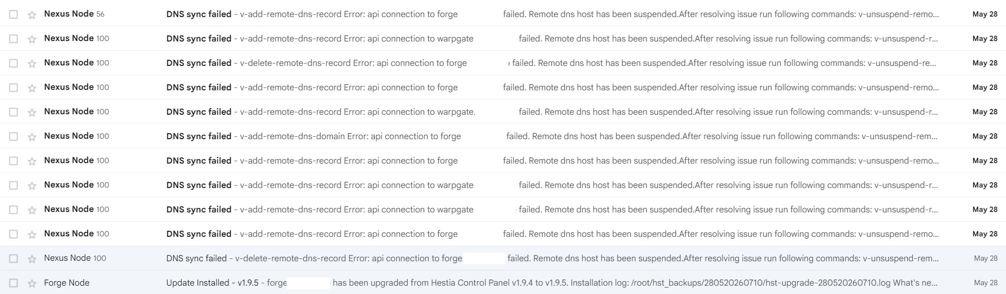

Hey, as to my understanding, the ability to diagnose where hestia’s scripts get stalled without deep diving is pretty limited, so I only did a surface level investigation. However, here’s what happened. I’m running a master → slave + slave setup and it’s been working fine for a long time. Then, I notice an avalanche of notifications:
Now, I made some dns changes on the master and went to see what’s happening on the slaves → nothing. I cleared some slave records and ran v-sync-dns-cluster on the master and noticed that the records were created on the slave but with no entries. Then I went and put set -x in the script to see what step it gets stalled and saw something like ‘15 destination server unreachable’ with no further logging. I curled the api endpoint and it was working just fine, I checked the keys and they were all fine as well. So, I deleted and readded the slaves through v-delete-remote-dns-host which didn’t want to work at first because of a missing parent directory (../.. nice touch) which I fixed locally. Still didn’t work. Then I tried changing ‘hestia-zone’ to ‘hestia’ on the slaves and it worked without a hitch again, so I left it at that. Does any of that help in any way? :))
