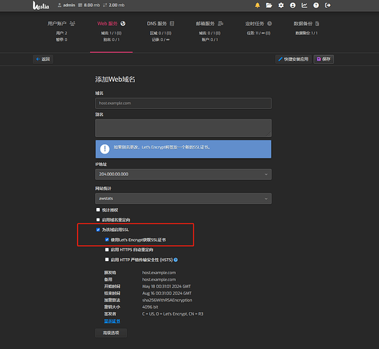

Please log in to Hestia management using IP: 8083 and select the management domain you have set on the following interface
Select to enable Let’s Encrypt certificate for this management domain! The reference is as follows
Don’t forget to click save after selecting, and you can access it normally after completion!
8083 is selected and SSL certificate is installed for Hestia management. It works actively.
