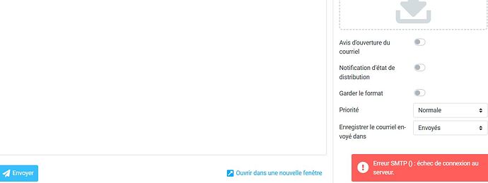

When trying to send an e-mail from Roundcube Webmail in Hestiacp, the following error appears. SMTP Error (): Connection to server failed.
Please attach the error log and related text!
The /var/log directory has a detailed Roundcube error log
how i can solve it please ??

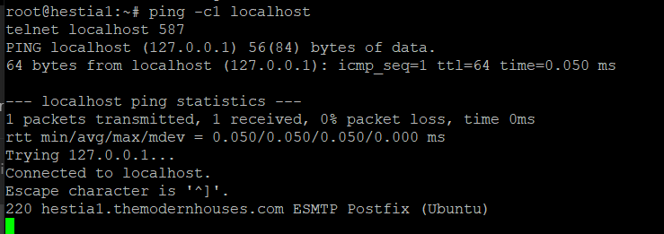

The problem is that Roundcube can’t connect to localhost on port 587, I suppose it’s because localhost resolves to ::1 (IPv6) but Exim is only listening on IPv4 .

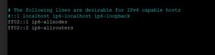

Edit file /etc/localhost and comment this line:
::1 localhost ip6-localhost ip6-loopback
so it will look like this:
#::1 localhost ip6-localhost ip6-loopback
Save the file and try again.
ping -c1 localhost
telnet localhost 587

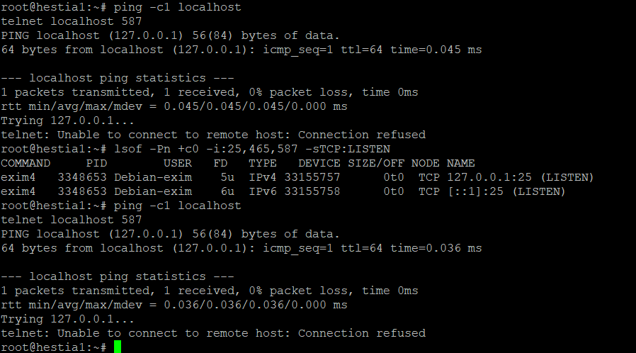

Do you know that you are using Postfix? If you are using Hestia you should have Exim.

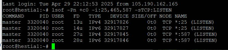

lsof -Pn +c0 -i:25,465,587 -sTCP:LISTEN
Okay, what should I do because my WordPress websites are unable to send emails, and SMTP is not working?
Well, you are not using Exim, you are using Postfix so that means that you are not using Hestia or you are using some mixed conf not supported by Hestia.
i am using hetsia may be confiraguration is not good
can you tell me what should i do please to use exim
Then you have a Frankenstein. I have no idea how you got into that situation, so I can’t help you here.
