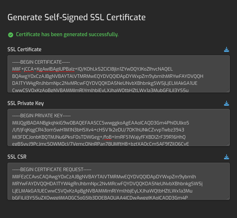

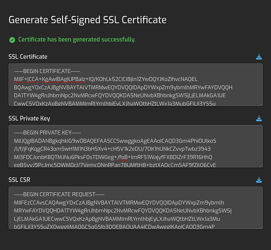

When you create a self-signed certificate using Hestia:
It stores the crt, csr and key in a random temporary directory /tmp/tmp.randomchars/YourDomain.{crt,csr,key}
But the same way you copied the CSR, copy the Key from the SSL Private Key field.
