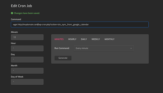

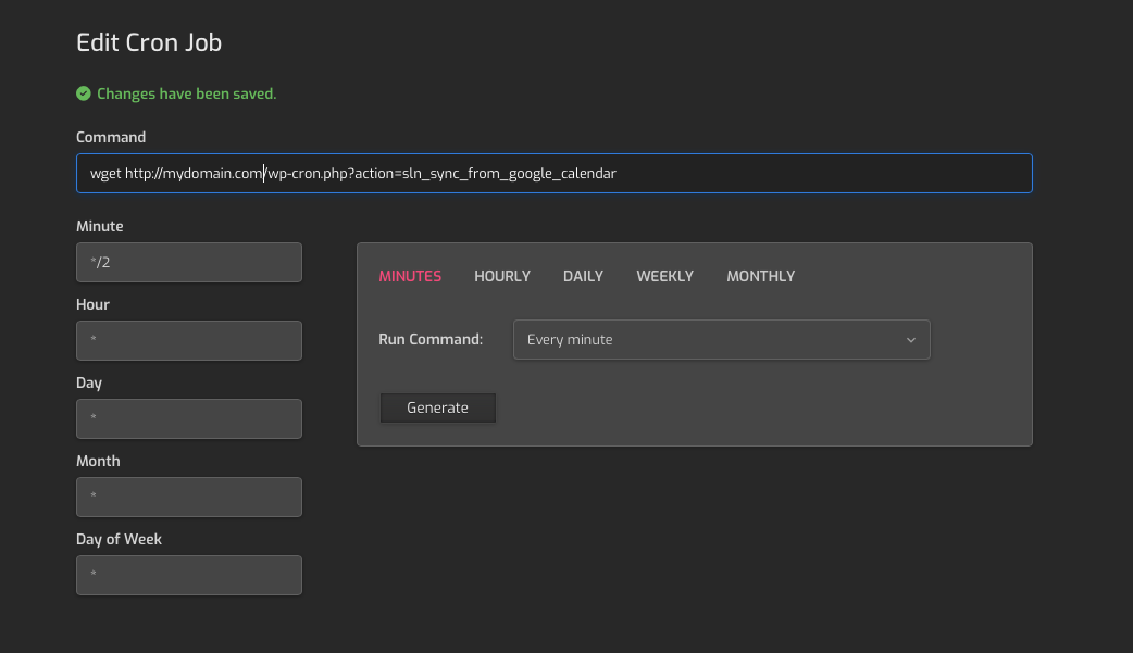

I changed the Control Panel of my VPS to Hestia.

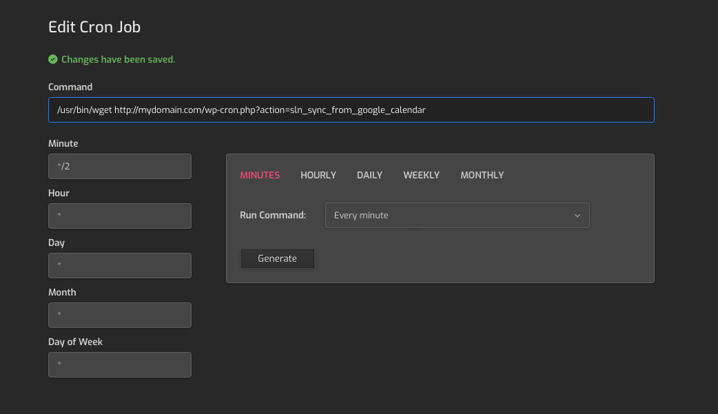

Before Hestia I was using the following cronjob via crontab :
*/2 * * * * wget -O - http://mydomain.com/wp-cron.php?action=sln_sync_from_google_calendar
Once on Hestia I’ve set the same :
I also tried via path :

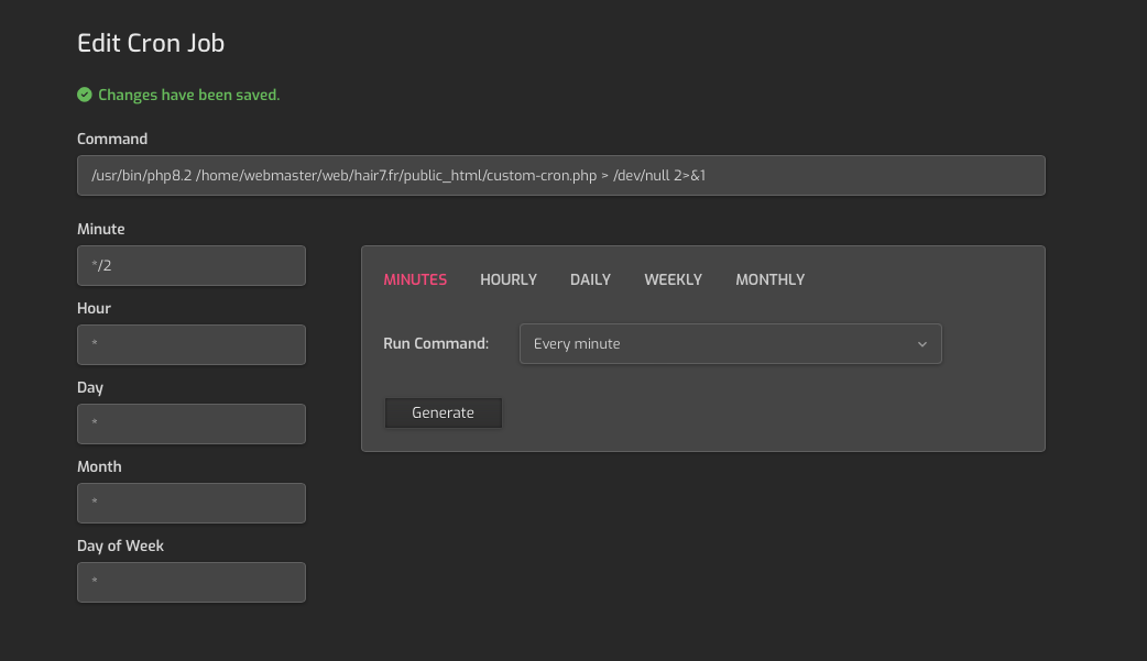

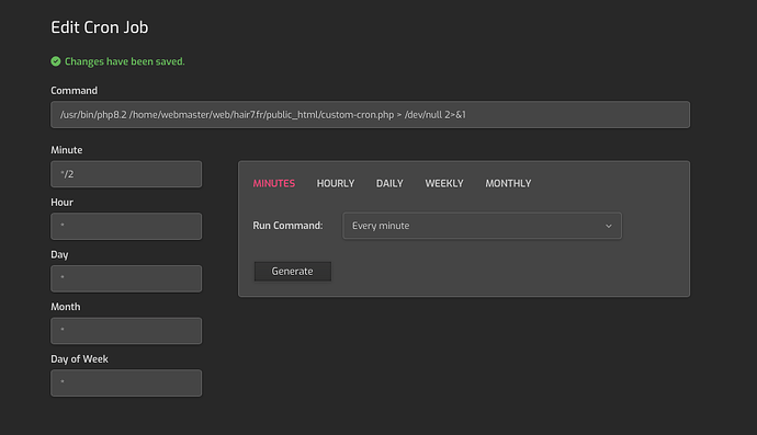

I also trie day creating a custom php file like this :
<?php
$_GET['action'] = 'sln_sync_from_google_calendar';
include 'wp-cron.php';
and the call the file :
But still not working.

Hi @IchCodes,
This cron job should work fine:
/usr/bin/wget -O - http://mydomain.com/wp-cron.php?action=sln_sync_from_google_calendar

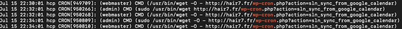

I know nothing about wordpress cron but one thing is to know whether the command is being executed and another thing is whether it does what you expect.
If you want to check whether the cron job is being executed:
grep wp-cron /var/log/syslog

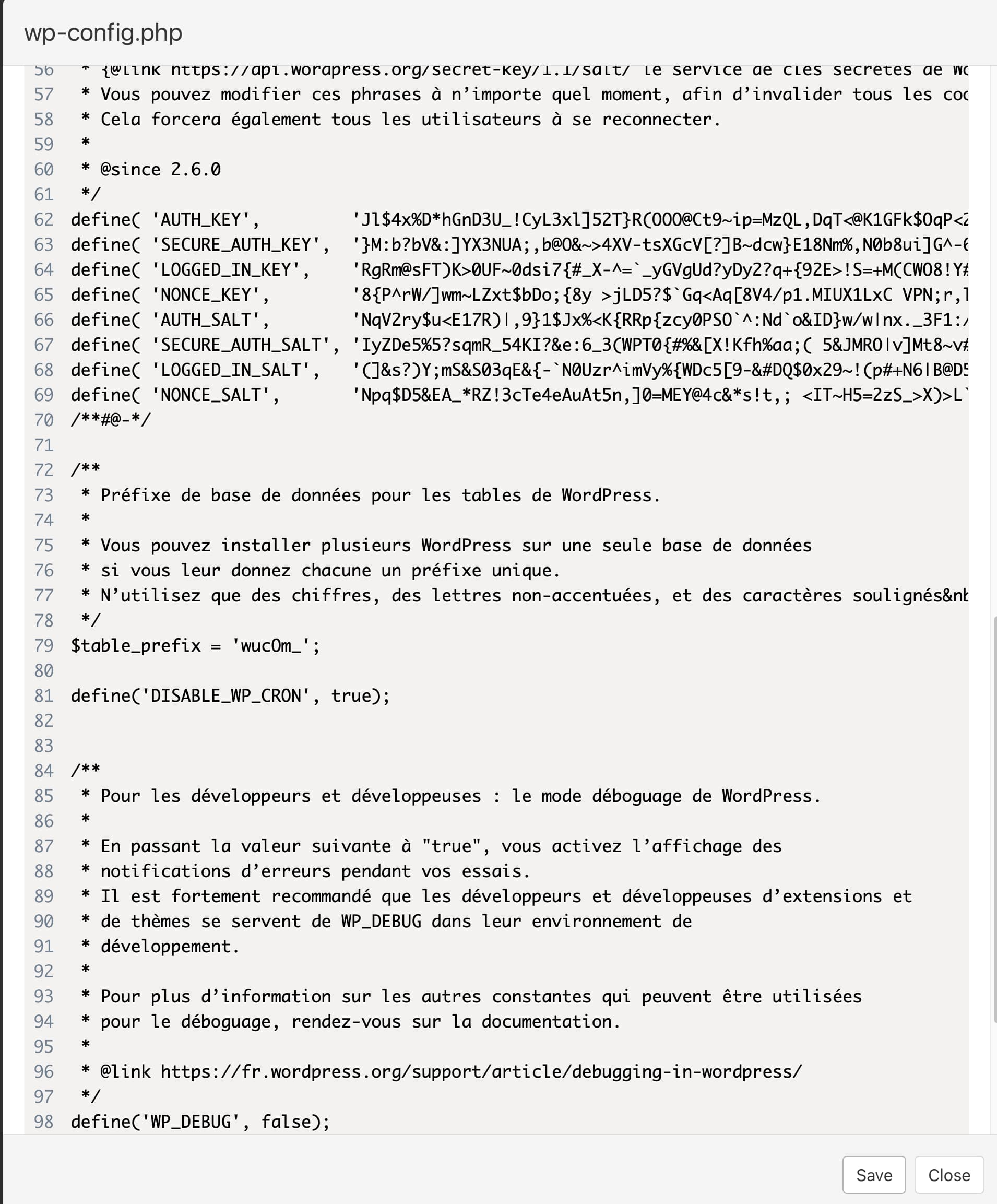

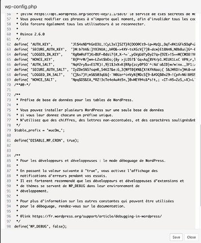

As far as I know, to use “real” cron jobs, you should disable wp cron:
define( 'DISABLE_WP_CRON', true );
Hi @sahsanu,
Thanks for your reply.
I’ve disabled wp-cron to test :
Then I keep the /usr/bin/wget -O - http://mydomain.com/wp-cron.php?action=sln_sync_from_google_calendar as cronjob as user and admin:
However it seems to be called but the result expected is not good.
