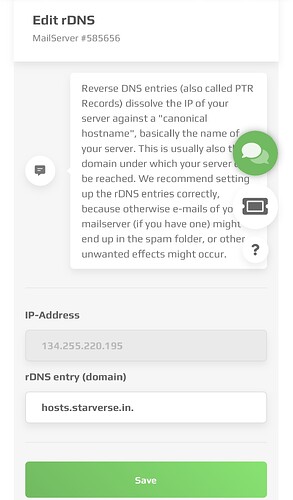

I have created the PTR record for rDNS lookup. But I’m not quite sure I made the correct record. Can you check this.
Where did you do that? I’m asking because it isn’t showing the right record (at least not yet).
Your hosting provider uses these DNS servers (ns1.zap-hosting.com and ns2.zap-hosting.com) to resolve the PTR records but:
ns1.zap-hosting.com shows nothing (NXDOMAIN):
$ dig @ns1.zap-hosting.com -x 134.255.220.195 | grep status
;; ->>HEADER<<- opcode: QUERY, status: NXDOMAIN, id: 44694
ns2.zap-hosting.com REFUSES to answer.
$ dig @ns2.zap-hosting.com -x 134.255.220.195 | grep status
;; ->>HEADER<<- opcode: QUERY, status: REFUSED, id: 52827

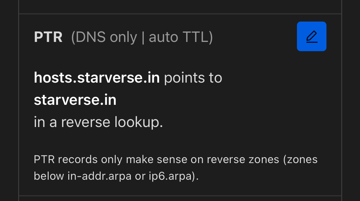

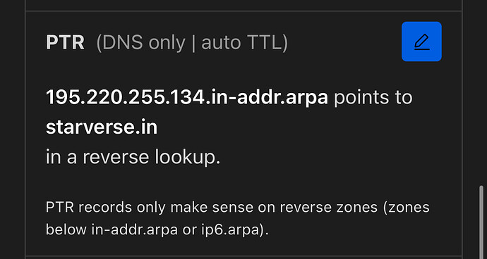

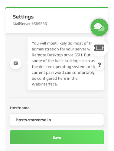

So here is what I did. I made sure that hostname and rDNS of the points to hosts.starverse.in
After that I went to my Cloudflare dashboard and pointed the PTR record to hosts.starverse.in.
And this solves the issues I’m been facing!:smiling_face_with_three_hearts:

Great, but only one of the DNS servers (ns1) is answering, the other one (ns2) is refusing to answer so there is something wrong with the second one and you should contact your hosting provider to know what’s going on.

This doesn’t make sense, why are you creating a PTR record on Cloudflare? And why hosts.starverse.in points to starverse.in?
I thought I’m supposed to do that, or aren’t I. Is it not required ? I’m confused. :thinking::face_with_spiral_eyes:
The PTR record must be added to the DNS servers of your hosting provider or the ones that manages the zone 220.255.134.in-addr.arpa. and in this case it is your hosting provider who manages them, not Cloudflare.
You hosting provider manages the zone 220.255.134.in-addr.arpa. using two dns servers; ns1.zap-hosting.com and ns2.zap-hosting.com and ns1 works fine but ns2 doesn’t and that is the reason you should contact to zap-hosting.com to know what the problem is.
So to put it in a simple way, the PTR records are only managed by the hosting provider and not the user. And users doesn’t need to setup PTR for their domain but request PTR record to hosting provider.
User need to tell their hosting provider what rdns they want. By default most hosting providers allow users to manage their own rdns.
Small chance some hosting providers need to be contacted to update rdns.
