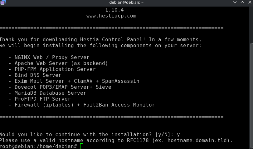

Hi @aaronkempf, I see what you mean , look, at home I do have one of those little brick size PC with Debian 13 and new Hestia 1.10.4 installed, it’s hostname is actually server.localhost.local, so .local is actually not the problem. The reason you can’t use (hostmane).local as you mentioned is to comply with RFC 1178, in the section “Avoid domain names”, actually if you try this (like I did trying to use debian.local) in a fresh install you will get this “Error”
So means you can’t use domain.tld directly, but you could try to use for example www.domain.tld (under your risk, I have no idea what could happend in this case).
