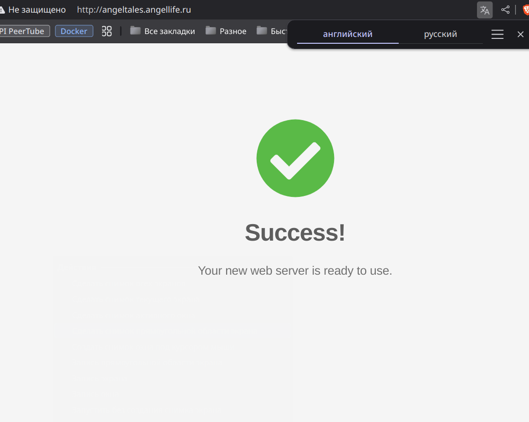

Hi everyone, I want to host PeerTube with Hestia , but I got a few difficulties with Nginx, in a simple way, my Peertube domain opens as one of the site domains in Hestia. I continue to test(I will change the domain, before that I used a subdomain, one domain with sites). I just decided to ask if it’s worth putting anything with Hestia at all? Thanks
I want to note that I don’t want to install PeerTube with Docker
Hi everyone, I tried different methods of Docker Peertube+Hestia, and didn’t get the result I want. In a simple way, I stop Nginx in Hestia to connect Peertube. And I changed the ports and forwarded them. But I don’t want Docker, I would like Hestia+Peertube to interact in the classic version of the installation. Now I installed Hestia+Peertube on the test server, but I get a page that is not secure http://angeltales.angellife.ru/. I added this domain to the Hestia panel, and I think that it looks like it’s worth creating a template for peertube(this is just a thought for now) so that peertube starts loading its page normally, and Hestia does its job.

Additional folders were also created and the site(peertube) was enabled, with its config
ls /etc/nginx
conf.d  fastcgi_params  mime.types  modules  modules-enabled  nginx.conf  scgi_params  sites-available  sites-enabled  uwsgi_params
config peertube nginx

Hestia and I have perfectly starting, but there is no access to Peertube, the Pertube server itself is in order, but Nginx proxy does not make it possible to combine all the difficulty in this.
You need to adjust and modify the nginx configuration of /home/peertube/conf/web/domain/, please refer to the installation log document I posted! Otherwise it doesn’t make any sense!
please do not suggest such thing, read the first 4 lines of your the configs you’re editing. It once again doesnt make sense.
There is no template loading for your domain, this is the default success message when you try to access the ip or there is no config for that specific domain. But as written, probaly better to install separated.
I understand, and yesterday I already tried to do it, but without successfully. I created a site in Hesatia, released a certificate and prescribed a new config /home/use/conf/web/angeltales.angellife.ru
