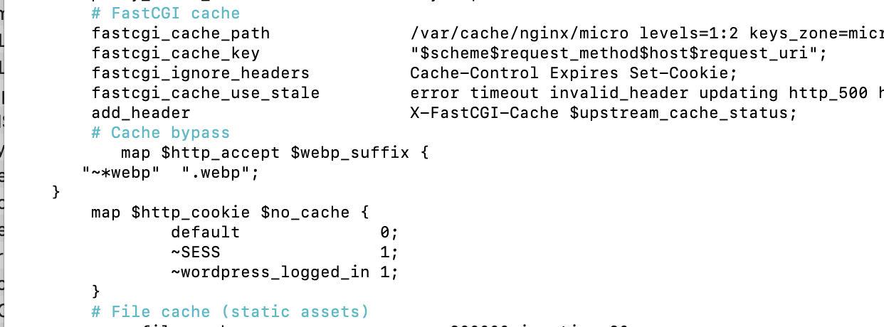

   map $http_accept $webp_suffix {
       "~*webp"  ".webp";
And
	        location ~ ^/wp-content/.*\.(png|jpe?g)$ {
                        root        %sdocroot%;
			expires     max;
                        add_header Vary Accept;
                        try_files $uri$webp_suffix $uri =404;

And for that:
       "~*webp"  ".webp";
I tried both in an http directive in my wordpress template and in the http directive of the nginx.conf but I couldn’t make it work :frowning:

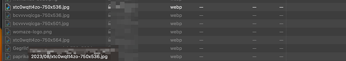

Make sure to clear your browser caches.
Hestia can be a bit picky with that …
Also please not it doesn’t change extension of the file:
But it should show webp instead of jpg…
I did clear all my caches, but I tried again and I cleared all of them once more and I even rebooted my server but yeah in “type” in “inspect element” I still have jpeg/jpg/png
