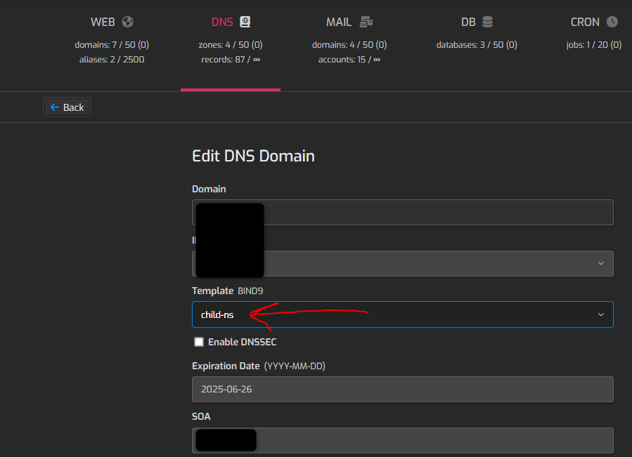

This issue merits further investigation. Can check what domain template you have selected in the dns domain, and provide the template ?
You can find it here: /usr/local/hestia/install/common/templates/dns

Regarding the DNS template, the issue is materializing for me using “default.tpl”
ID='1' RECORD='@' TYPE='NS' PRIORITY='' VALUE='%ns1%.' SUSPENDED='no' TIME='%time%' DATE='%date%'
ID='2' RECORD='@' TYPE='NS' PRIORITY='' VALUE='%ns2%.' SUSPENDED='no' TIME='%time%' DATE='%date%'
ID='3' RECORD='@' TYPE='NS' PRIORITY='' VALUE='%ns3%.' SUSPENDED='no' TIME='%time%' DATE='%date%'
ID='4' RECORD='@' TYPE='NS' PRIORITY='' VALUE='%ns4%.' SUSPENDED='no' TIME='%time%' DATE='%date%'
ID='5' RECORD='@' TYPE='NS' PRIORITY='' VALUE='%ns5%.' SUSPENDED='no' TIME='%time%' DATE='%date%'
ID='6' RECORD='@' TYPE='NS' PRIORITY='' VALUE='%ns6%.' SUSPENDED='no' TIME='%time%' DATE='%date%'
ID='7' RECORD='@' TYPE='NS' PRIORITY='' VALUE='%ns7%.' SUSPENDED='no' TIME='%time%' DATE='%date%'
ID='8' RECORD='@' TYPE='NS' PRIORITY='' VALUE='%ns8%.' SUSPENDED='no' TIME='%time%' DATE='%date%'
ID='9' RECORD='@' TYPE='A' PRIORITY='' VALUE='%ip%' SUSPENDED='no' TIME='%time%' DATE='%date%'
ID='10' RECORD='www' TYPE='CNAME' PRIORITY='' VALUE='%domain%.' SUSPENDED='no' TIME='%time%' DATE='%date%'
ID='11' RECORD='ftp' TYPE='CNAME' PRIORITY='' VALUE='%domain%.' SUSPENDED='no' TIME='%time%' DATE='%date%'
ID='12' RECORD='mail' TYPE='A' PRIORITY='' VALUE='%ip%' SUSPENDED='no' TIME='%time%' DATE='%date%'
ID='13' RECORD='webmail' TYPE='CNAME' PRIORITY='' VALUE='mail.%domain%.' SUSPENDED='no' TIME='%time%' DATE='%date%'
ID='14' RECORD='@' TYPE='MX' PRIORITY='0' VALUE='mail.%domain%.' SUSPENDED='no' TIME='%time%' DATE='%date%'
ID='15' RECORD='@' TYPE='TXT' PRIORITY='' VALUE='"v=spf1 a mx ip4:%ip% -all"' SUSPENDED='no' TIME='%time%' DATE='%date%'
ID='16' RECORD='_dmarc' TYPE='TXT' PRIORITY='' VALUE='"v=DMARC1; p=quarantine; pct=100"' SUSPENDED='no' TIME='%time%' DATE='%date%'
ID='17' RECORD='_submission._tcp' TYPE='SRV' PRIORITY='1' VALUE='0 587 mail.%domain%.' SUSPENDED='no' TIME='%time%' DATE='%date%'
ID='18' RECORD='_imap._tcp' TYPE='SRV' PRIORITY='1' VALUE='0 143 mail.%domain%.' SUSPENDED='no' TIME='%time%' DATE='%date%'
ID='19' RECORD='_imaps._tcp' TYPE='SRV' PRIORITY='1' VALUE='0 993 mail.%domain%.' SUSPENDED='no' TIME='%time%' DATE='%date%'
ID='20' RECORD='_pop3._tcp' TYPE='SRV' PRIORITY='1' VALUE='0 110 mail.%domain%.' SUSPENDED='no' TIME='%time%' DATE='%date%'
ID='21' RECORD='_pop3s._tcp' TYPE='SRV' PRIORITY='1' VALUE='0 995 mail.%domain%.' SUSPENDED='no' TIME='%time%' DATE='%date%'
