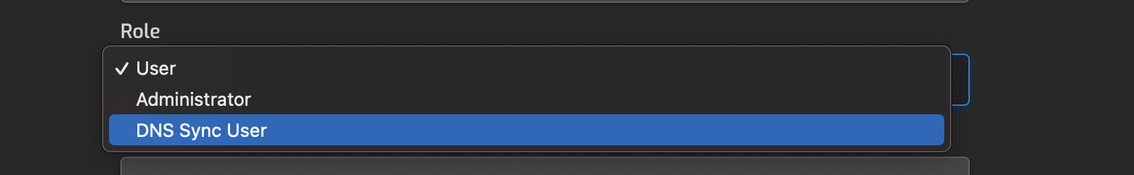

I deleted the previous dns cluster user and recreated as dns-user with dns role. In 10 minutes after adding remote dns for host 3, host 1 and 2 (slave) starts deleting zone records of host 3.

or assign the “Role”
That will prevent it from accidentally syncing…
@eris I did both, i added username as dns-user and set role as dns sync user. Do i need to change the username or probably not since i assigned role dns sync user.
