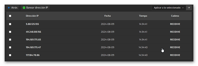

after that I’ve put
systemctl restart fail2ban
and the results
[09-Aug-2024 12:37:32 +0000]: <4ss5i6nf> IMAP Error: Login failed for [email protected] against localhost from 77.243.86.16 (X-Forwarded-For: 77.243.86.16). AUTHENTICATE PLAIN: Authentication failed. in /var/lib/roundcube/program/lib/Roundcube/rcube_imap.php on line 211 (POST /?_task=login&_action=login)
[09-Aug-2024 12:37:50 +0000]: <4ss5i6nf> IMAP Error: Login failed for [email protected] against localhost from 77.243.86.16 (X-Forwarded-For: 77.243.86.16). AUTHENTICATE PLAIN: Authentication failed. in /var/lib/roundcube/program/lib/Roundcube/rcube_imap.php on line 211 (POST /?_task=login&_action=login)
[09-Aug-2024 12:38:04 +0000]: <4ss5i6nf> IMAP Error: Login failed for [email protected] against localhost from 77.243.86.16 (X-Forwarded-For: 77.243.86.16). AUTHENTICATE PLAIN: Authentication failed. in /var/lib/roundcube/program/lib/Roundcube/rcube_imap.php on line 211 (POST /?_task=login&_action=login)
[09-Aug-2024 12:38:36 +0000]: <4ss5i6nf> IMAP Error: Login failed for [email protected] against localhost from 77.243.86.16 (X-Forwarded-For: 77.243.86.16). AUTHENTICATE PLAIN: Authentication failed. in /var/lib/roundcube/program/lib/Roundcube/rcube_imap.php on line 211 (POST /?_task=login&_action=login)
[09-Aug-2024 12:38:52 +0000]: <4ss5i6nf> IMAP Error: Login failed for [email protected] against localhost from 77.243.86.16 (X-Forwarded-For: 77.243.86.16). AUTHENTICATE PLAIN: Authentication failed. in /var/lib/roundcube/program/lib/Roundcube/rcube_imap.php on line 211 (POST /?_task=login&_action=login)
[09-Aug-2024 12:39:10 +0000]: <4ss5i6nf> IMAP Error: Login failed for [email protected] against localhost from 77.243.86.16 (X-Forwarded-For: 77.243.86.16). AUTHENTICATE PLAIN: Authentication failed. in /var/lib/roundcube/program/lib/Roundcube/rcube_imap.php on line 211 (POST /?_task=login&_action=login)
[09-Aug-2024 12:40:46 +0000]: <4ss5i6nf> IMAP Error: Login failed for [email protected] against localhost from 77.243.86.16 (X-Forwarded-For: 77.243.86.16). AUTHENTICATE PLAIN: Authentication failed. in /var/lib/roundcube/program/lib/Roundcube/rcube_imap.php on line 211 (POST /?_task=login&_action=login)
it doesn’t work
The Ip isn’t banned
greetings

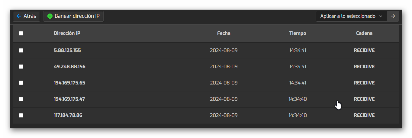

Hi
On more thing.
The hour isn’t correct. The curretly hour in spain is 14:57 Pm, but in the result is diferent.
It’ something rare.
greeting
But you are not using the modified regex I’ve posted
