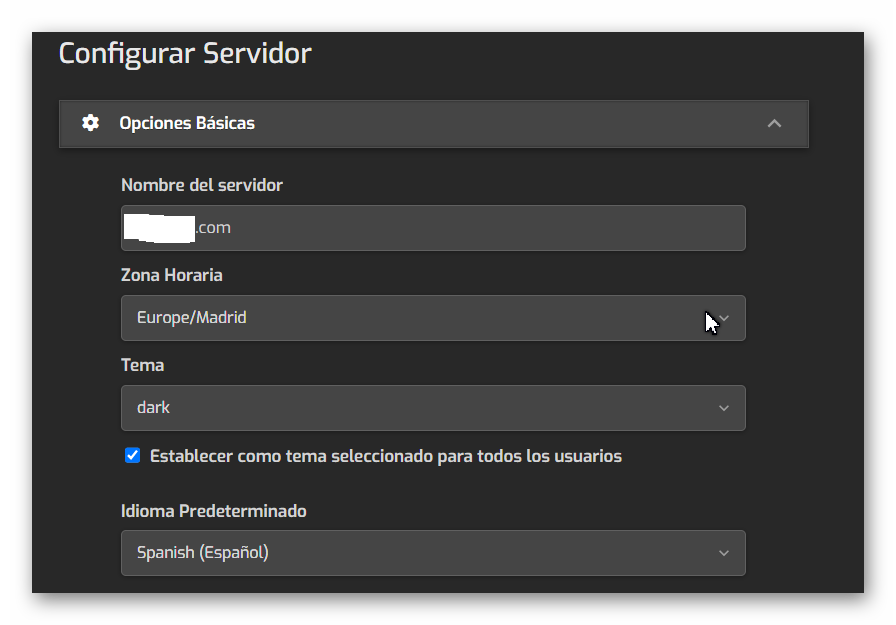

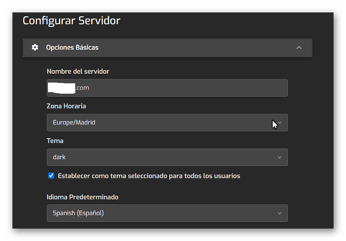

sahsanu thanks for following up with timwol. I went straight to bed after my last post.
yes my times were off as I never set the TZ in php.ini .

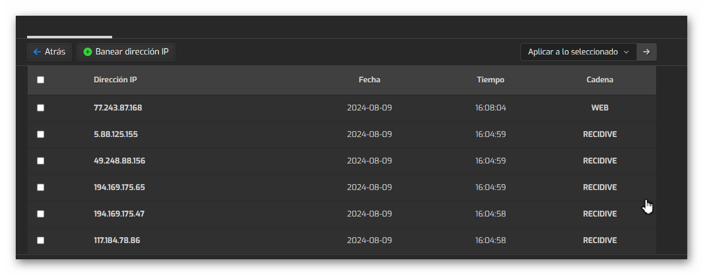

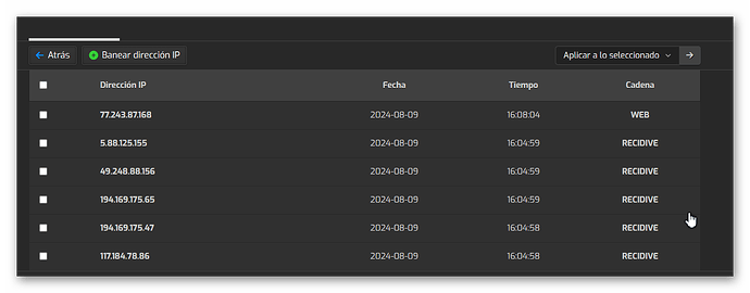

I think he he is asking which sections should be removed from the ‘banned IP’ list in Hestia admin section.
roundcube will be listed as WEB . It is in line 50 of /etc/fail2ban/jail.local
But if you own IP is listed as banned in WEB or MAIL , I would take them both out :slight_smile:
Hi sahsanu
In the screnshoot when the IP is banned appear WEB.
Shouldn’t appear mail instead?
greetings
No. Hestia is banning the IP from the web server ports. roundcube is a web app.
