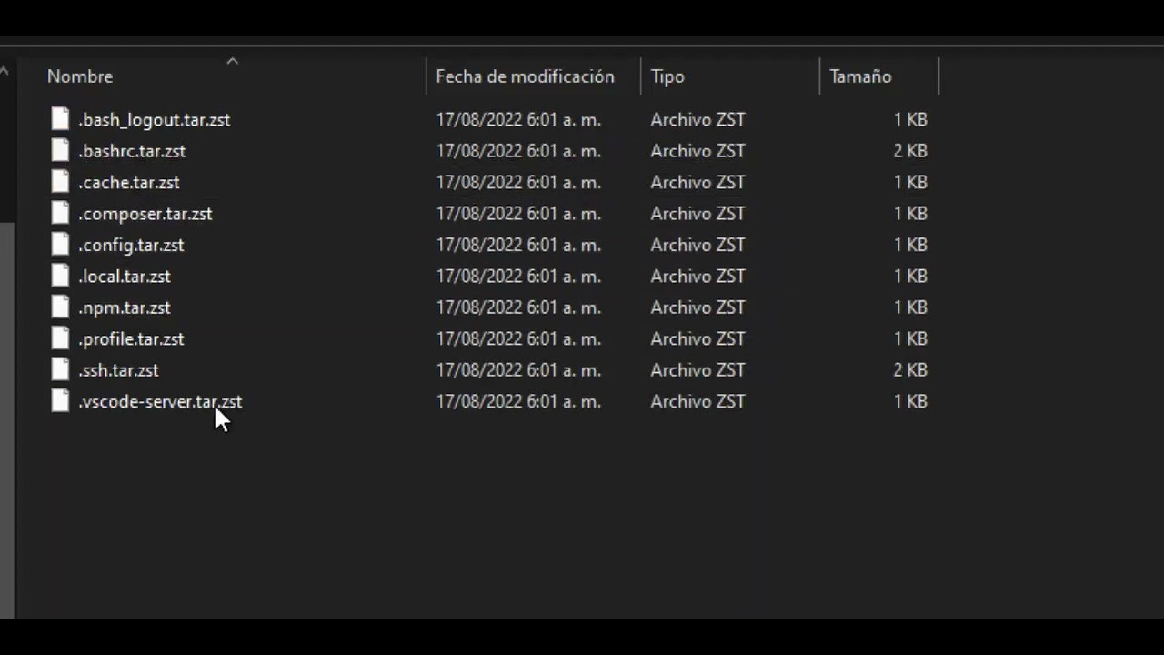

hello, the backup copies do not have that information, they only have configuration files, I attach a screenshot, in other forums I have consulted and they tell me that they only have that

Unless you altered your backup preferences, the backup will contain the user config files, all websites, all databases, and files in your user directory. However, the best way to restore them is not to open the file and sort through manually, but to use the v-restore-user script or the web interface. These restore utilities understand the file format and how things are stored in there.
If you want to check what was backed up, there will be a log file in the /backup/ directory which you can look at, named as user.log
If you’re not seeing everything you expect to see in there, then check Hestia CP backup section, for that user, and look to see if any domains, databases etc have been excluded in the “Backup Exclusions” section.

I attach a video where you can see the content of the backups that hestia generates, please review it if the backups should not be seen that way please tell me how to correct it, install hestiacp and do not modify any of those backup items.

The information that you seek is in that files. You just need to understand what you are seeing.
Of course there are more files and directories that you don’t need.

The directory structure matches the /home/user structure in hestia.
You will find
  • web domains in the web folder. You will have to look for the public_html folder which I don’t remember where it is.
  • and databases in the db folder your video shows clearly the database when you visit the db folder.
This looks like your database:
uversieducativa.dbwordpress.mysql.sql.zstd
Since hestiacp doesn’t match webs with databases you will have to choose the correct ones.

I had not understood the example of the way to extract from the colleague, I had to download this file (zstd for Windows download | SourceForge.net) and paste it in the path of the file to “extract”, I see which is a different extraction method but it works.
In this way I realize that the information of the websites if they are in the backup.
