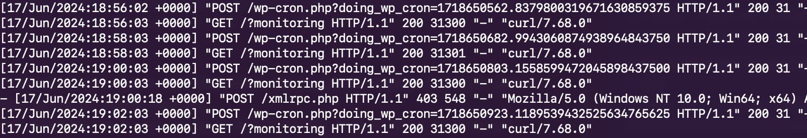

              Hi everyone!
Also, I’ve just noticed that all the sites’ visits are recorded with HTTP1.1 but in the above file I see the http2 set to on

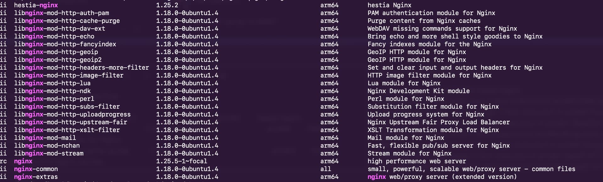

              So your server is ARM?
The mainline version for nginx is not installed, it is using an old ubuntu version 1.18.
Show me the output of this command:
dpkg -l | grep 'nginx'

              And what happened there?, why nginx is uninstalled and the rest of nginx packages are installed from Ubuntu repo instead of nginx repo?
                Ade
                    June 21, 2024,  9:30pm
                  14
              So you have a bit mess there

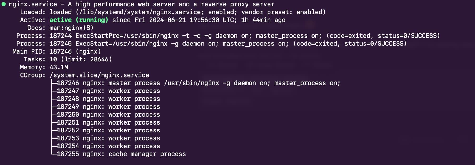

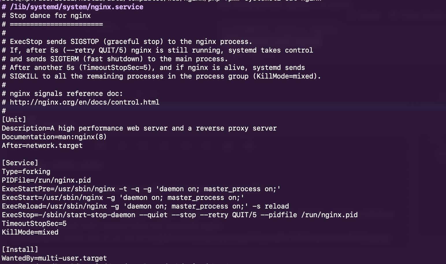

And what you did to install nginx? Did you compile it yourself? I’m asking because nginx package is not installed but nginx -V works.
systemctl status nginx
systemctl cat nginx
type nginx
                Ade
Honestly, I don’t remember
nginx is hashed (/usr/sbin/nginx)
              Ok, you are using Ubuntu version. http_v2 module is enabled in your nginx version (I saw it in nginx -V command output).
Well, seens directive http2 was not supported  in nginx 1.18 so to enable http2, edit your domain conf and add http2 to listen directive.

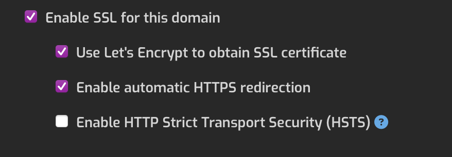

              This is exactly how I did it and it worked fine, however that causes the page to be prompt to download when visiting via http:// as the https redirect doesn’t happen
              Did you enable https redirect for your site?

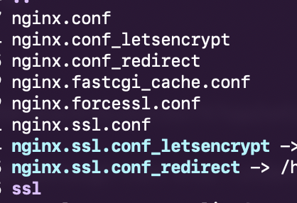

              In the site conf folder for web I have the following files:
In the nginx.conf there’s an include for the nginx.forcessl.conf although from what I understand, the conf file that the site is actually loading is nginx.ssl.conf
Would you like to see the full file? If so, which one?
