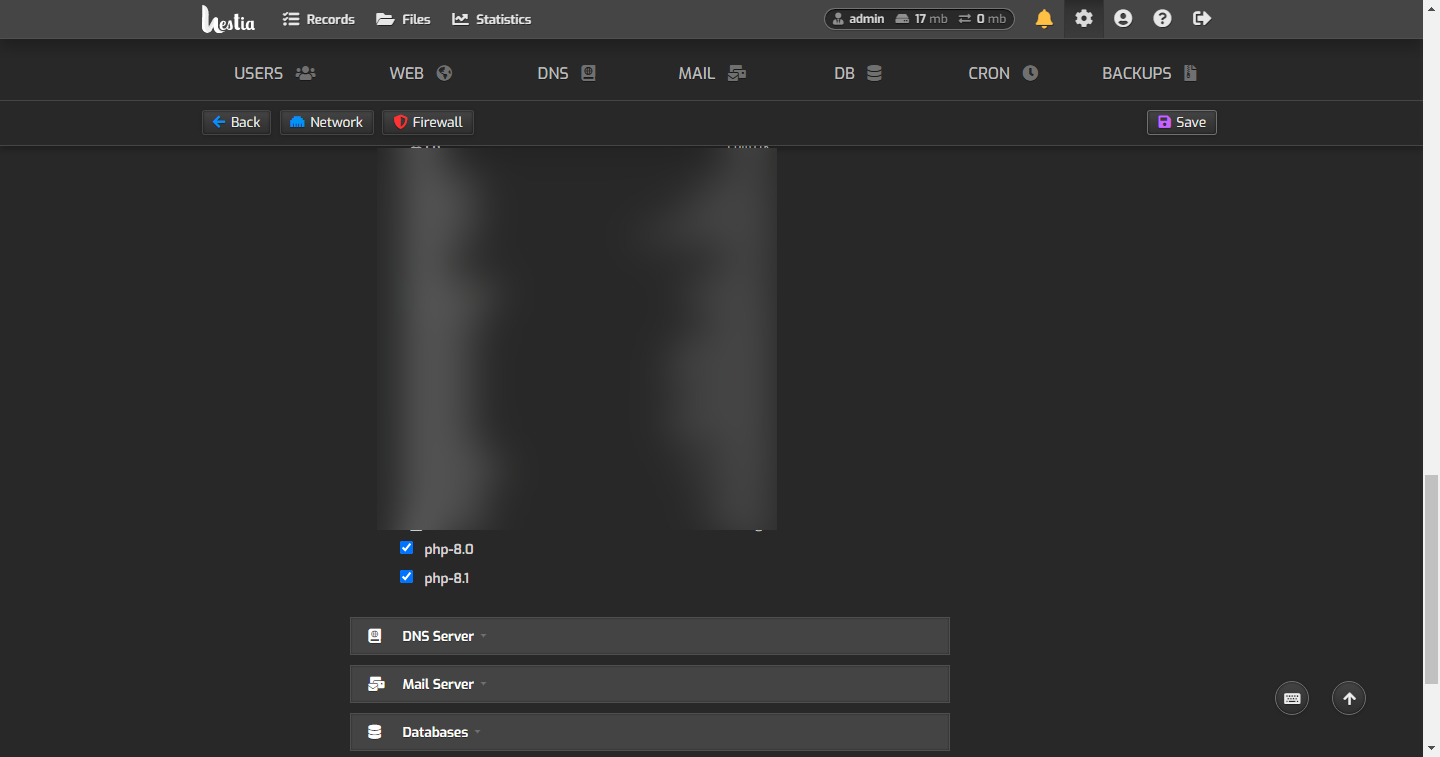

I marked it from the panel and installed it like that, maybe the server blocked the connection or there was a port conflict and it couldn’t be installed completely
