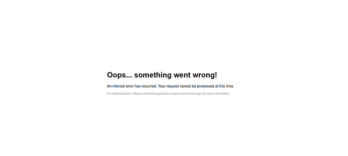

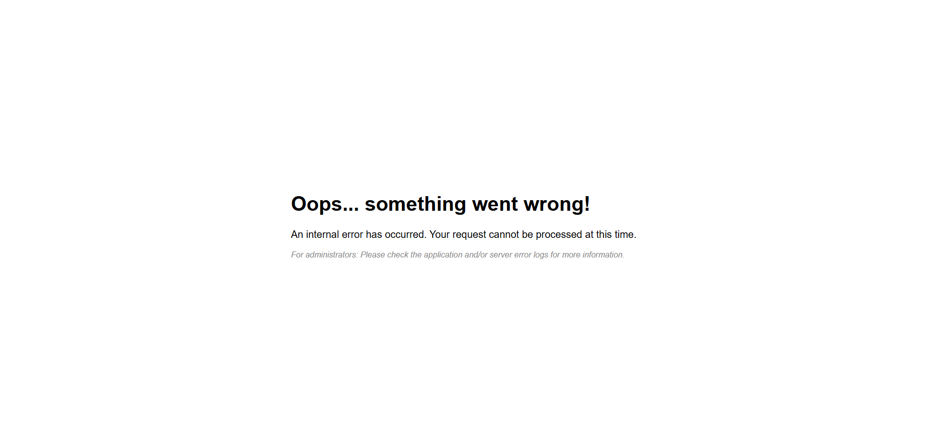

I controlled nginx configs;
/var/log/nginx/domains/webmail.domain.be.log
122.XXX.123.XX - - [28/Apr/2025:20:40:14 +0300] "GET / HTTP/2.0" 500 634 "-" "Mozilla/5.0 (Windows NT 10.0; Win64; x64) AppleWebKit/537.36 (KHTML, like Gecko) Chrome/135.0.0.0 Safari/537.36"
122.XXX.123.XX - - [28/Apr/2025:20:40:21 +0300] "GET / HTTP/2.0" 500 634 "-" "Mozilla/5.0 (Windows NT 10.0; Win64; x64) AppleWebKit/537.36 (KHTML, like Gecko) Chrome/135.0.0.0 Safari/537.36"
122.XXX.123.XX - - [28/Apr/2025:20:40:21 +0300] "GET /favicon.ico HTTP/2.0" 404 1422 "https://webmail.domain.be/" "Mozilla/5.0 (Windows NT 10.0; Win64; x64) AppleWebKit/537.36 (KHTML, like Gecko) Chrome/135.0.0.0 Safari/537.36"
122.XXX.123.XX - - [28/Apr/2025:20:41:11 +0300] "GET / HTTP/2.0" 500 634 "-" "Mozilla/5.0 (Windows NT 10.0; Win64; x64) AppleWebKit/537.36 (KHTML, like Gecko) Chrome/135.0.0.0 Safari/537.36"
122.XXX.123.XX - - [28/Apr/2025:20:41:12 +0300] "GET / HTTP/2.0" 500 634 "-" "Mozilla/5.0 (Windows NT 10.0; Win64; x64) AppleWebKit/537.36 (KHTML, like Gecko) Chrome/135.0.0.0 Safari/537.36"
122.XXX.123.XX - - [28/Apr/2025:20:41:13 +0300] "GET / HTTP/2.0" 500 634 "-" "Mozilla/5.0 (Windows NT 10.0; Win64; x64) AppleWebKit/537.36 (KHTML, like Gecko) Chrome/135.0.0.0 Safari/537.36"
122.XXX.123.XX - - [28/Apr/2025:20:41:32 +0300] "GET / HTTP/2.0" 500 634 "-" "Mozilla/5.0 (Windows NT 10.0; Win64; x64) AppleWebKit/537.36 (KHTML, like Gecko) Chrome/135.0.0.0 Safari/537.36"
122.XXX.123.XX - - [28/Apr/2025:20:45:00 +0300] "GET / HTTP/2.0" 500 634 "-" "Mozilla/5.0 (Windows NT 10.0; Win64; x64) AppleWebKit/537.36 (KHTML, like Gecko) Chrome/135.0.0.0 Safari/537.36"
122.XXX.123.XX - - [28/Apr/2025:20:52:04 +0300] "GET / HTTP/2.0" 200 2413 "-" "Mozilla/5.0 (Windows NT 10.0; Win64; x64) AppleWebKit/537.36 (KHTML, like Gecko) Chrome/135.0.0.0 Safari/537.36"
122.XXX.123.XX - - [28/Apr/2025:20:52:05 +0300] "GET / HTTP/2.0" 200 2413 "-" "Mozilla/5.0 (Windows NT 10.0; Win64; x64) AppleWebKit/537.36 (KHTML, like Gecko) Chrome/135.0.0.0 Safari/537.36"
122.XXX.123.XX - - [28/Apr/2025:20:52:25 +0300] "POST /?_task=login HTTP/2.0" 500 634 "https://webmail.domain.be/" "Mozilla/5.0 (Windows NT 10.0; Win64; x64) AppleWebKit/537.36 (KHTML, like Gecko) Chrome/135.0.0.0 Safari/537.36"

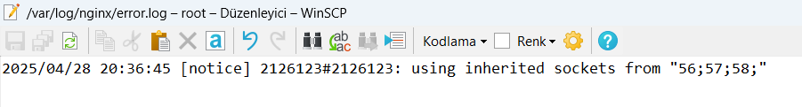

/var/log/nginx/domains/webmail.domain.be.error.log

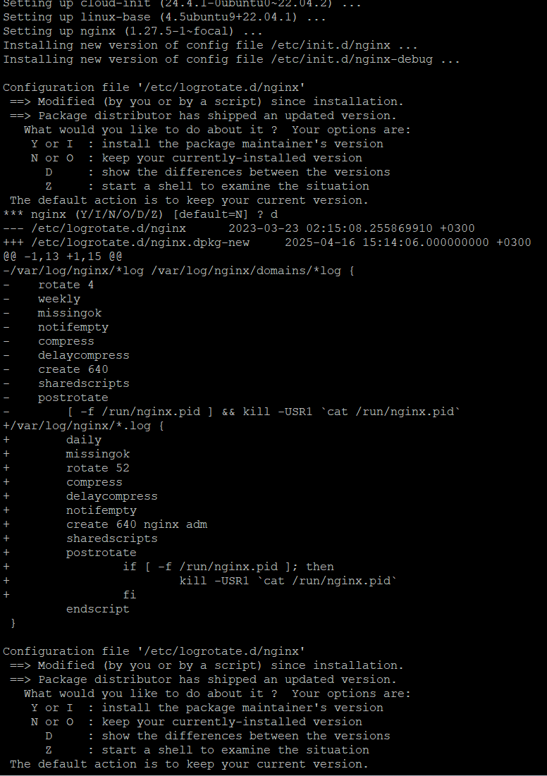

new nginx update is applied but Δ± selected to keep my current config version. while apt-upgrade-y

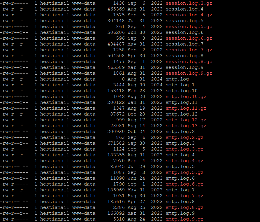

chown -R hestiamail:www-data /var/log/roundcube

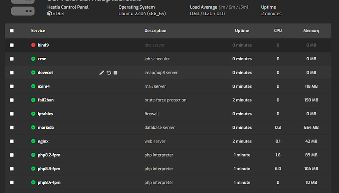

I used this but nothing changed. Also I cant run bind9 service
Same error in log?
ls -la /var/log/roundcube/
Check the service status.
Δ± dont get new log after aug 2024 for roundcube.
sudo systemctl status bind9
Γ— named.service - BIND Domain Name Server
     Loaded: loaded (/lib/systemd/system/named.service; enabled; vendor preset: enabled)
     Active: failed (Result: exit-code) since Mon 2025-04-28 23:33:55 +03; 2min 30s ago
       Docs: man:named(8)
    Process: 15925 ExecStart=/usr/sbin/named $OPTIONS (code=exited, status=1/FAILURE)
        CPU: 15ms
Apr 28 23:33:55 serve.domain.club systemd[1]: named.service: Scheduled restart job, restart counter is at 5.
Apr 28 23:33:55 serve.domain.club systemd[1]: Stopped BIND Domain Name Server.
Apr 28 23:33:55 serve.domain.club systemd[1]: named.service: Start request repeated too quickly.
Apr 28 23:33:55 serve.domain.club systemd[1]: named.service: Failed with result 'exit-code'.
Apr 28 23:33:55 serve.domain.club systemd[1]: Failed to start BIND Domain Name Server.

Regarding bind9, restart the service and check the log:
systemctl restart bind9
grep -E 'named\s*\[[0-9]' /var/log/syslog | tail -n50
Sorry I could not share logs, Iwass offline for two days.
Job for named.service failed because the control process exited with error code.
See "systemctl status named.service" and "journalctl -xeu named.service" for details.

var log nginx for webmail.domainx.com
Stack trace:
#0 /var/lib/roundcube/program/lib/Roundcube/rcube_utils.php(1200): rcube_utils::idn_convert()
#1 /var/lib/roundcube/program/include/rcmail.php(761): rcube_utils::idn_to_ascii()
#2 /var/lib/roundcube/index.php(119): rcmail->login()
#3 {main}
  thrown in /var/lib/roundcube/program/lib/Roundcube/rcube_utils.php on line 1236" while reading response header from upstream, client: 1XX.1XX.2XX.XX, server: webmail.domainx.club, request: "POST /?_task=login HTTP/2.0", upstream: "fastcgi://unix:/run/php/www.sock:", host: "webmail.domainx.club", referrer: "https://webmail.domainx.club/"
2025/04/28 22:31:32 [error] 2126125#2126125: *10231 FastCGI sent in stderr: "PHP message: PHP Deprecated:  Calling get_class() without arguments is deprecated in /var/lib/roundcube/vendor/pear/pear-core-minimal/src/PEAR.php on line 235" while reading response header from upstream, client: 1XX.1XX.2XX.XX, server: webmail.domainx.club, request: "GET / HTTP/2.0", upstream: "fastcgi://unix:/run/php/www.sock:", host: "webmail.domainx.club"
2025/04/28 22:31:35 [error] 2126125#2126125: *10231 FastCGI sent in stderr: "PHP message: PHP Deprecated:  Calling get_class() without arguments is deprecated in /var/lib/roundcube/vendor/pear/pear-core-minimal/src/PEAR.php on line 235" while reading response header from upstream, client: 1XX.1XX.2XX.XX, server: webmail.domainx.club, request: "POST /?_task=login HTTP/2.0", upstream: "fastcgi://unix:/run/php/www.sock:", host: "webmail.domainx.club", referrer: "https://webmail.domainx.club/"
2025/04/28 22:55:53 [error] 4105#4105: *988 FastCGI sent in stderr: "PHP message: PHP Deprecated:  Calling get_class() without arguments is deprecated in /var/lib/roundcube/vendor/pear/pear-core-minimal/src/PEAR.php on line 235" while reading response header from upstream, client: 1XX.1XX.2XX.XX, server: webmail.domainx.club, request: "GET / HTTP/2.0", upstream: "fastcgi://unix:/run/php/www.sock:", host: "webmail.domainx.club"
2025/04/28 22:55:54 [error] 4105#4105: *988 FastCGI sent in stderr: "PHP message: PHP Deprecated:  Calling get_class() without arguments is deprecated in /var/lib/roundcube/vendor/pear/pear-core-minimal/src/PEAR.php on line 235" while reading response header from upstream, client: 1XX.1XX.2XX.XX, server: webmail.domainx.club, request: "POST /?_task=login HTTP/2.0", upstream: "fastcgi://unix:/run/php/www.sock:", host: "webmail.domainx.club", referrer: "https://webmail.domainx.club/"
2025/04/28 22:59:35 [error] 4105#4105: *1195 FastCGI sent in stderr: "PHP message: PHP Deprecated:  Calling get_class() without arguments is deprecated in /var/lib/roundcube/vendor/pear/pear-core-minimal/src/PEAR.php on line 235" while reading response header from upstream, client: 1XX.1XX.2XX.XX, server: webmail.domainx.club, request: "GET / HTTP/2.0", upstream: "fastcgi://unix:/run/php/www.sock:", host: "webmail.domainx.club"
2025/04/28 22:59:36 [error] 4105#4105: *1195 FastCGI sent in stderr: "PHP message: PHP Deprecated:  Calling get_class() without arguments is deprecated in /var/lib/roundcube/vendor/pear/pear-core-minimal/src/PEAR.php on line 235" while reading response header from upstream, client: 1XX.1XX.2XX.XX, server: webmail.domainx.club, request: "POST /?_task=login HTTP/2.0", upstream: "fastcgi://unix:/run/php/www.sock:", host: "webmail.domainx.club", referrer: "https://webmail.domainx.club/"
2025/04/28 23:26:48 [error] 992#992: *542 FastCGI sent in stderr: "PHP message: PHP Deprecated:  Calling get_class() without arguments is deprecated in /var/lib/roundcube/vendor/pear/pear-core-minimal/src/PEAR.php on line 235" while reading response header from upstream, client: 1XX.1XX.2XX.XX, server: webmail.domainx.club, request: "GET / HTTP/2.0", upstream: "fastcgi://unix:/run/php/www.sock:", host: "webmail.domainx.club"
2025/04/28 23:26:49 [error] 992#992: *542 FastCGI sent in stderr: "PHP message: PHP Deprecated:  Calling get_class() without arguments is deprecated in /var/lib/roundcube/vendor/pear/pear-core-minimal/src/PEAR.php on line 235" while reading response header from upstream, client: 1XX.1XX.2XX.XX, server: webmail.domainx.club, request: "POST /?_task=login HTTP/2.0", upstream: "fastcgi://unix:/run/php/www.sock:", host: "webmail.domainx.club", referrer: "https://webmail.domainx.club/"
2025/04/28 23:30:20 [error] 992#992: *752 FastCGI sent in stderr: "PHP message: PHP Deprecated:  Calling get_class() without arguments is deprecated in /var/lib/roundcube/vendor/pear/pear-core-minimal/src/PEAR.php on line 235" while reading response header from upstream, client: 1XX.1XX.2XX.XX, server: webmail.domainx.club, request: "GET / HTTP/2.0", upstream: "fastcgi://unix:/run/php/www.sock:", host: "webmail.domainx.club"
2025/04/28 23:30:21 [error] 992#992: *752 FastCGI sent in stderr: "PHP message: PHP Deprecated:  Calling get_class() without arguments is deprecated in /var/lib/roundcube/vendor/pear/pear-core-minimal/src/PEAR.php on line 235" while reading response header from upstream, client: 1XX.1XX.2XX.XX, server: webmail.domainx.club, request: "POST /?_task=login HTTP/2.0", upstream: "fastcgi://unix:/run/php/www.sock:", host: "webmail.domainx.club", referrer: "https://webmail.domainx.club/"
2025/04/29 03:29:38 [error] 21111#21111: *30452 FastCGI sent in stderr: "PHP message: PHP Deprecated:  Calling get_class() without arguments is deprecated in /var/lib/roundcube/vendor/pear/pear-core-minimal/src/PEAR.php on line 235" while reading response header from upstream, client: 3.112.246.87, server: webmail.domainx.club, request: "GET / HTTP/1.1", upstream: "fastcgi://unix:/run/php/www.sock:", host: "webmail.domainx.club"
2025/04/29 04:29:40 [error] 21111#21111: *35428 FastCGI sent in stderr: "PHP message: PHP Deprecated:  Calling get_class() without arguments is deprecated in /var/lib/roundcube/vendor/pear/pear-core-minimal/src/PEAR.php on line 235" while reading response header from upstream, client: 198.235.24.236, server: webmail.domainx.club, request: "GET / HTTP/1.1", upstream: "fastcgi://unix:/run/php/www.sock:", host: "webmail.domainx.club"
2025/04/29 04:59:59 [error] 21111#21111: *37850 FastCGI sent in stderr: "PHP message: PHP Deprecated:  Calling get_class() without arguments is deprecated in /var/lib/roundcube/vendor/pear/pear-core-minimal/src/PEAR.php on line 235" while reading response header from upstream, client: 198.44.137.54, server: webmail.domainx.club, request: "GET / HTTP/1.1", upstream: "fastcgi://unix:/run/php/www.sock:", host: "mail.domainx.club"
2025/04/29 05:00:36 [error] 21111#21111: *37953 FastCGI sent in stderr: "PHP message: PHP Deprecated:  Calling get_class() without arguments is deprecated in /var/lib/roundcube/vendor/pear/pear-core-minimal/src/PEAR.php on line 235" while reading response header from upstream, client: 198.44.137.54, server: webmail.domainx.club, request: "GET / HTTP/1.1", upstream: "fastcgi://unix:/run/php/www.sock:", host: "webmail.domainx.club"
2025/04/29 05:00:44 [error] 21111#21111: *37971 FastCGI sent in stderr: "PHP message: PHP Deprecated:  Calling get_class() without arguments is deprecated in /var/lib/roundcube/vendor/pear/pear-core-minimal/src/PEAR.php on line 235" while reading response header from upstream, client: 198.44.137.54, server: webmail.domainx.club, request: "GET / HTTP/1.1", upstream: "fastcgi://unix:/run/php/www.sock:", host: "webmail.domainx.club"
2025/04/29 08:02:18 [error] 81667#81667: *51392 FastCGI sent in stderr: "PHP message: PHP Deprecated:  Calling get_class() without arguments is deprecated in /var/lib/roundcube/vendor/pear/pear-core-minimal/src/PEAR.php on line 235" while reading response header from upstream, client: 198.44.137.54, server: webmail.domainx.club, request: "GET / HTTP/1.1", upstream: "fastcgi://unix:/run/php/www.sock:", host: "webmail.domainx.club"
2025/04/29 08:02:36 [error] 81667#81667: *51449 FastCGI sent in stderr: "PHP message: PHP Deprecated:  Calling get_class() without arguments is deprecated in /var/lib/roundcube/vendor/pear/pear-core-minimal/src/PEAR.php on line 235" while reading response header from upstream, client: 111.7.96.160, server: webmail.domainx.club, request: "GET / HTTP/1.1", upstream: "fastcgi://unix:/run/php/www.sock:", host: "webmail.domainx.club", referrer: "http://mail.domainx.club"
2025/04/29 15:37:53 [error] 81670#81670: *82294 FastCGI sent in stderr: "PHP message: PHP Deprecated:  Calling get_class() without arguments is deprecated in /var/lib/roundcube/vendor/pear/pear-core-minimal/src/PEAR.php on line 235" while reading response header from upstream, client: 205.210.31.241, server: webmail.domainx.club, request: "GET / HTTP/1.1", upstream: "fastcgi://unix:/run/php/www.sock:", host: "mail.domainx.club"
2025/04/30 06:01:04 [error] 286147#286147: *162904 FastCGI sent in stderr: "PHP message: PHP Deprecated:  Calling get_class() without arguments is deprecated in /var/lib/roundcube/vendor/pear/pear-core-minimal/src/PEAR.php on line 235" while reading response header from upstream, client: 149.102.230.133, server: webmail.domainx.club, request: "GET / HTTP/1.1", upstream: "fastcgi://unix:/run/php/www.sock:", host: "webmail.domainx.club"
2025/04/30 06:01:04 [error] 286147#286147: *162904 FastCGI sent in stderr: "Primary script unknown" while reading response header from upstream, client: 149.102.230.133, server: webmail.domainx.club, request: "GET //xmlrpc.php?rsd HTTP/1.1", upstream: "fastcgi://unix:/run/php/www.sock:", host: "webmail.domainx.club"
2025/04/30 12:41:35 [error] 286147#286147: *211663 FastCGI sent in stderr: "PHP message: PHP Deprecated:  Calling get_class() without arguments is deprecated in /var/lib/roundcube/vendor/pear/pear-core-minimal/src/PEAR.php on line 235" while reading response header from upstream, client: 143.198.135.127, server: webmail.domainx.club, request: "GET / HTTP/1.1", upstream: "fastcgi://unix:/run/php/www.sock:", host: "mail.domainx.club"
2025/04/30 19:58:41 [error] 286147#286147: *237348 FastCGI sent in stderr: "PHP message: PHP Deprecated:  Calling get_class() without arguments is deprecated in /var/lib/roundcube/vendor/pear/pear-core-minimal/src/PEAR.php on line 235" while reading response header from upstream, client: 111.7.96.161, server: webmail.domainx.club, request: "GET / HTTP/1.1", upstream: "fastcgi://unix:/run/php/www.sock:", host: "mail.domainx.club"
2025/04/30 19:58:42 [error] 286147#286147: *237354 FastCGI sent in stderr: "PHP message: PHP Deprecated:  Calling get_class() without arguments is deprecated in /var/lib/roundcube/vendor/pear/pear-core-minimal/src/PEAR.php on line 235" while reading response header from upstream, client: 111.7.96.161, server: webmail.domainx.club, request: "GET / HTTP/1.1", upstream: "fastcgi://unix:/run/php/www.sock:", host: "mail.domainx.club"
2025/04/30 23:01:13 [error] 286147#286147: *246246 FastCGI sent in stderr: "PHP message: PHP Deprecated:  Calling get_class() without arguments is deprecated in /var/lib/roundcube/vendor/pear/pear-core-minimal/src/PEAR.php on line 235" while reading response header from upstream, client: 45.92.19.139, server: webmail.domainx.club, request: "GET / HTTP/1.1", upstream: "fastcgi://unix:/run/php/www.sock:", host: "webmail.domainx.club"
2025/05/02 00:21:42 [error] 472960#472960: *315454 FastCGI sent in stderr: "PHP message: PHP Deprecated:  Calling get_class() without arguments is deprecated in /var/lib/roundcube/vendor/pear/pear-core-minimal/src/PEAR.php on line 235" while reading response header from upstream, client: 188.132.248.3, server: webmail.domainx.club, request: "GET / HTTP/2.0", upstream: "fastcgi://unix:/run/php/www.sock:", host: "webmail.domainx.club"
2025/05/02 00:21:44 [error] 472960#472960: *315454 FastCGI sent in stderr: "PHP message: PHP Deprecated:  Calling get_class() without arguments is deprecated in /var/lib/roundcube/vendor/pear/pear-core-minimal/src/PEAR.php on line 235; PHP message: PHP Warning:  file_put_contents(/var/log/roundcube/session.log): Failed to open stream: Permission denied in /var/lib/roundcube/program/lib/Roundcube/rcube.php on line 1381; PHP message: PHP Fatal error:  Uncaught Error: Undefined constant "INTL_IDNA_VARIANT_UTS46" in /var/lib/roundcube/program/lib/Roundcube/rcube_utils.php:1236
Stack trace:
#3 {main}
  thrown in /var/lib/roundcube/program/lib/Roundcube/rcube_utils.php on line 1236" while reading response header from upstream, client: 188.132.248.3, server: webmail.domainx.club, request: "POST /?_task=login HTTP/2.0", upstream: "fastcgi://unix:/run/php/www.sock:", host: "webmail.domainx.club", referrer: "https://webmail.domainx.club/"
total 653468
drwxr-xr-x  2 www-data www-data      4096 Apr 29 00:00 .
drwxr-xr-x 19 root     syslog       12288 May  1 00:00 ..
-rwxr-xr-x  1 www-data www-data         0 Mar 18  2021 errors
-rw-r--r--  1 www-data www-data         0 Apr 29 00:00 errors.log
-rwxr-xr-x  1 www-data www-data      4056 Apr 28 23:30 errors.log.1
-rwxr-xr-x  1 www-data www-data   1182137 Mar 31  2023 errors.log.10
-rwxr-xr-x  1 www-data www-data      1807 Aug 30  2022 errors.log.10.gz
-rwxr-xr-x  1 www-data www-data   1494297 Feb 28  2023 errors.log.11
-rwxr-xr-x  1 www-data www-data       404 Aug 29  2022 errors.log.11.gz
-rwxr-xr-x  1 www-data www-data   1377137 Jan 31  2023 errors.log.12
-rwxr-xr-x  1 www-data www-data       363 Aug 28  2022 errors.log.12.gz
-rwxr-xr-x  1 www-data www-data       217 Aug 27  2022 errors.log.13.gz
-rwxr-xr-x  1 www-data www-data       466 Aug 26  2022 errors.log.14.gz
-rwxr-xr-x  1 www-data www-data    818706 Aug 28  2024 errors.log.2
-rwxr-xr-x  1 www-data www-data      1639 Sep  7  2022 errors.log.2.gz
-rwxr-xr-x  1 www-data www-data     25804 Oct 24  2023 errors.log.3
-rwxr-xr-x  1 www-data www-data      1158 Sep  6  2022 errors.log.3.gz
-rwxr-xr-x  1 www-data www-data     55356 Sep 30  2023 errors.log.4
-rwxr-xr-x  1 www-data www-data      1419 Sep  5  2022 errors.log.4.gz
-rwxr-xr-x  1 www-data www-data     20775 Aug 31  2023 errors.log.5
-rwxr-xr-x  1 www-data www-data      1125 Sep  4  2022 errors.log.5.gz
-rwxr-xr-x  1 www-data www-data     10468 Jul 30  2023 errors.log.6
-rwxr-xr-x  1 www-data www-data       361 Sep  3  2022 errors.log.6.gz
-rwxr-xr-x  1 www-data www-data      5592 Jun 26  2023 errors.log.7
-rwxr-xr-x  1 www-data www-data      1230 Sep  2  2022 errors.log.7.gz
-rwxr-xr-x  1 www-data www-data     26329 May 31  2023 errors.log.8
-rwxr-xr-x  1 www-data www-data      1372 Sep  1  2022 errors.log.8.gz
-rwxr-xr-x  1 www-data www-data     16708 Apr 27  2023 errors.log.9
-rwxr-xr-x  1 www-data www-data      1808 Aug 31  2022 errors.log.9.gz
-rw-r--r--  1 www-data www-data         0 Aug 28  2024 imap.log
-rwxr-xr-x  1 www-data www-data    345280 Aug 27  2024 imap.log.1
-rwxr-xr-x  1 www-data www-data  32029080 Feb 28  2023 imap.log.10
-rwxr-xr-x  1 www-data www-data    181476 Aug 30  2022 imap.log.10.gz
-rwxr-xr-x  1 www-data www-data  44830384 Jan 31  2023 imap.log.11
-rwxr-xr-x  1 www-data www-data     46409 Aug 29  2022 imap.log.11.gz
-rwxr-xr-x  1 www-data www-data 123599871 Dec 31  2022 imap.log.12
-rwxr-xr-x  1 www-data www-data     38207 Aug 28  2022 imap.log.12.gz
-rwxr-xr-x  1 www-data www-data     40318 Aug 27  2022 imap.log.13.gz
-rwxr-xr-x  1 www-data www-data     56727 Aug 26  2022 imap.log.14.gz
-rwxr-xr-x  1 www-data www-data  46263042 Oct 24  2023 imap.log.2
-rwxr-xr-x  1 www-data www-data     88274 Sep  7  2022 imap.log.2.gz
-rwxr-xr-x  1 www-data www-data  91203860 Sep 30  2023 imap.log.3
-rwxr-xr-x  1 www-data www-data   1826486 Sep  6  2022 imap.log.3.gz
-rwxr-xr-x  1 www-data www-data 102599114 Aug 31  2023 imap.log.4
-rwxr-xr-x  1 www-data www-data    129531 Sep  5  2022 imap.log.4.gz
-rwxr-xr-x  1 www-data www-data  24892341 Jul 31  2023 imap.log.5
-rwxr-xr-x  1 www-data www-data     72224 Sep  4  2022 imap.log.5.gz
-rwxr-xr-x  1 www-data www-data  39979185 Jun 30  2023 imap.log.6
-rwxr-xr-x  1 www-data www-data     61933 Sep  3  2022 imap.log.6.gz
-rwxr-xr-x  1 www-data www-data  71951072 May 31  2023 imap.log.7
-rwxr-xr-x  1 www-data www-data     72629 Sep  2  2022 imap.log.7.gz
-rwxr-xr-x  1 www-data www-data  36270476 Apr 30  2023 imap.log.8
-rwxr-xr-x  1 www-data www-data    244169 Sep  1  2022 imap.log.8.gz
-rwxr-xr-x  1 www-data www-data  39489538 Mar 31  2023 imap.log.9
-rwxr-xr-x  1 www-data www-data    141090 Aug 31  2022 imap.log.9.gz
-rw-r--r--  1 www-data www-data         0 Aug  5  2022 sendmail.log
-rwxr-xr-x  1 www-data www-data       228 Aug  4  2022 sendmail.log.1
-rwxr-xr-x  1 www-data www-data       202 Jul 12  2022 sendmail.log.10.gz
-rwxr-xr-x  1 www-data www-data       642 Jul  6  2022 sendmail.log.11.gz
-rwxr-xr-x  1 www-data www-data       323 Jul  5  2022 sendmail.log.12.gz
-rwxr-xr-x  1 www-data www-data       515 Jul  4  2022 sendmail.log.13.gz
-rwxr-xr-x  1 www-data www-data       208 Jul  3  2022 sendmail.log.14.gz
-rwxr-xr-x  1 www-data www-data       199 Aug  2  2022 sendmail.log.2.gz
-rwxr-xr-x  1 www-data www-data       202 Aug  1  2022 sendmail.log.3.gz
-rwxr-xr-x  1 www-data www-data       199 Jul 29  2022 sendmail.log.4.gz
-rwxr-xr-x  1 www-data www-data       255 Jul 25  2022 sendmail.log.5.gz
-rwxr-xr-x  1 www-data www-data       267 Jul 21  2022 sendmail.log.6.gz
-rwxr-xr-x  1 www-data www-data       257 Jul 20  2022 sendmail.log.7.gz
-rwxr-xr-x  1 www-data www-data       202 Jul 19  2022 sendmail.log.8.gz
-rwxr-xr-x  1 www-data www-data       196 Jul 18  2022 sendmail.log.9.gz
-rw-r--r--  1 www-data www-data         0 Apr 29 00:00 session.log
-rwxr-xr-x  1 www-data www-data       850 Apr 28 23:30 session.log.1
-rwxr-xr-x  1 www-data www-data    465589 Mar 31  2023 session.log.10
-rwxr-xr-x  1 www-data www-data      1712 Aug 30  2022 session.log.10.gz
-rwxr-xr-x  1 www-data www-data    374733 Feb 28  2023 session.log.11
-rwxr-xr-x  1 www-data www-data       569 Aug 29  2022 session.log.11.gz
-rwxr-xr-x  1 www-data www-data    458896 Jan 31  2023 session.log.12
-rwxr-xr-x  1 www-data www-data       508 Aug 28  2022 session.log.12.gz
-rwxr-xr-x  1 www-data www-data       368 Aug 27  2022 session.log.13.gz
-rwxr-xr-x  1 www-data www-data       533 Aug 26  2022 session.log.14.gz
-rwxr-xr-x  1 www-data www-data      1277 Aug 27  2024 session.log.2
-rwxr-xr-x  1 www-data www-data      1491 Sep  7  2022 session.log.2.gz
-rwxr-xr-x  1 www-data www-data    431573 Oct 24  2023 session.log.3
-rwxr-xr-x  1 www-data www-data      1438 Sep  6  2022 session.log.3.gz
-rwxr-xr-x  1 www-data www-data    690368 Sep 30  2023 session.log.4
-rwxr-xr-x  1 www-data www-data      1575 Sep  5  2022 session.log.4.gz
-rwxr-xr-x  1 www-data www-data    465369 Aug 31  2023 session.log.5
-rwxr-xr-x  1 www-data www-data       861 Sep  4  2022 session.log.5.gz
-rwxr-xr-x  1 www-data www-data    304148 Jul 31  2023 session.log.6
-rwxr-xr-x  1 www-data www-data       596 Sep  3  2022 session.log.6.gz
-rwxr-xr-x  1 www-data www-data    506206 Jun 30  2023 session.log.7
-rwxr-xr-x  1 www-data www-data      1258 Sep  2  2022 session.log.7.gz
-rwxr-xr-x  1 www-data www-data    434487 May 31  2023 session.log.8
-rwxr-xr-x  1 www-data www-data      1477 Sep  1  2022 session.log.8.gz
-rwxr-xr-x  1 www-data www-data    504508 Apr 30  2023 session.log.9
-rwxr-xr-x  1 www-data www-data      1861 Aug 31  2022 session.log.9.gz
-rw-r--r--  1 www-data www-data         0 Aug 31  2024 smtp.log
-rwxr-xr-x  1 www-data www-data      3444 Aug 30  2024 smtp.log.1
-rwxr-xr-x  1 www-data www-data    153418 Feb 28  2023 smtp.log.10
-rwxr-xr-x  1 www-data www-data      1042 Aug 20  2022 smtp.log.10.gz
-rwxr-xr-x  1 www-data www-data    200122 Jan 31  2023 smtp.log.11
-rwxr-xr-x  1 www-data www-data      1347 Aug 19  2022 smtp.log.11.gz
-rwxr-xr-x  1 www-data www-data     87672 Dec 28  2022 smtp.log.12
-rwxr-xr-x  1 www-data www-data       999 Aug 17  2022 smtp.log.12.gz
-rwxr-xr-x  1 www-data www-data     28081 Aug 14  2022 smtp.log.13.gz
-rwxr-xr-x  1 www-data www-data    200930 Oct 24  2023 smtp.log.2
-rwxr-xr-x  1 www-data www-data       863 Sep  6  2022 smtp.log.2.gz
-rwxr-xr-x  1 www-data www-data    671582 Sep 30  2023 smtp.log.3
-rwxr-xr-x  1 www-data www-data      1124 Sep  5  2022 smtp.log.3.gz
-rwxr-xr-x  1 www-data www-data    183355 Aug 31  2023 smtp.log.4
-rwxr-xr-x  1 www-data www-data      7970 Sep  4  2022 smtp.log.4.gz
-rwxr-xr-x  1 www-data www-data     85045 Jul 29  2023 smtp.log.5
-rwxr-xr-x  1 www-data www-data      1087 Sep  3  2022 smtp.log.5.gz
-rwxr-xr-x  1 www-data www-data     11090 Jun 24  2023 smtp.log.6
-rwxr-xr-x  1 www-data www-data      1790 Sep  1  2022 smtp.log.6.gz
-rwxr-xr-x  1 www-data www-data    186969 May 31  2023 smtp.log.7
-rwxr-xr-x  1 www-data www-data      1031 Aug 30  2022 smtp.log.7.gz
-rwxr-xr-x  1 www-data www-data    185616 Apr 27  2023 smtp.log.8
-rwxr-xr-x  1 www-data www-data      2386 Aug 25  2022 smtp.log.8.gz
-rwxr-xr-x  1 www-data www-data    166092 Mar 31  2023 smtp.log.9
-rwxr-xr-x  1 www-data www-data      5310 Aug 24  2022 smtp.log.9.gz

-rw-r--r--  1 hestiamail www-data  12714 Feb  8 11:47 INSTALL
-rw-r--r--  1 hestiamail www-data  35147 Feb  8 11:47 LICENSE
drwxr-xr-x  2 hestiamail www-data   4096 Aug  9  2022 logs
drwxr-xr-x 37 hestiamail www-data   4096 Feb  8 11:47 plugins
drwxr-xr-x  8 hestiamail www-data   4096 Feb  8 11:47 program
drwxr-xr-x  3 hestiamail www-data   4096 Aug  9  2022 public_html
-rw-r--r--  1 hestiamail www-data   3853 Feb  8 11:47 README.md
-rw-r--r--  1 hestiamail www-data     26 Aug  9  2022 robots.txt
-rw-r--r--  1 hestiamail www-data    967 Aug  9  2022 SECURITY.md
drwxr-xr-x  3 hestiamail www-data   4096 Feb  8 11:47 skins
drwxr-xr-x  7 hestiamail www-data   4096 Feb  8 11:47 SQL
drwxr-xr-x  2 hestiamail www-data   4096 Feb 28 09:04 temp
-rw-r--r--  1 hestiamail www-data   4657 Feb  8 11:47 UPGRADING
drwxr-xr-x 14 hestiamail www-data   4096 Aug  9  2022 vendor
