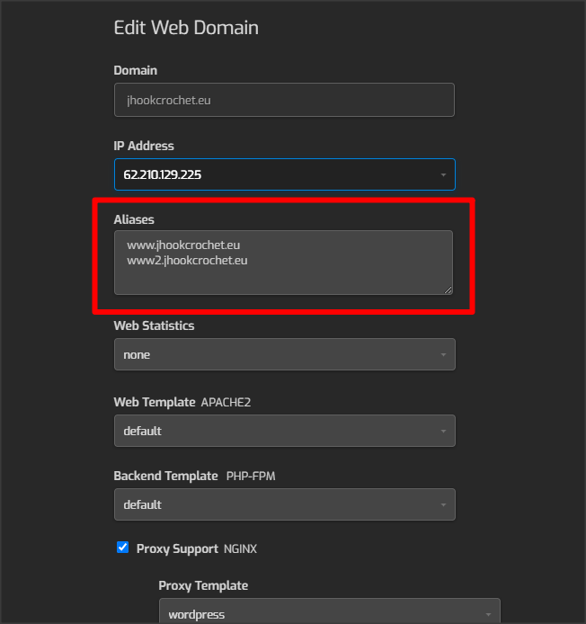

just add your www alias to the aliases section of your non-www domain. Take a look at this example.
My domain is “www.domain.com
Alias is “domain.com

for domain.tld it will add ww.domain.tld as alias, for www.domain.tld it will handle it as subdomain and does not add the www alias (which would be www.www.domain.tld) - all good here.
I’m not talking about the alias. This part here in the image. I added www.domain.com and it didn’t save it as that, only as domain.com, unless last time when I was able to save it as www.domain.com was the glitch? What about the web domain doesn’t exist?
