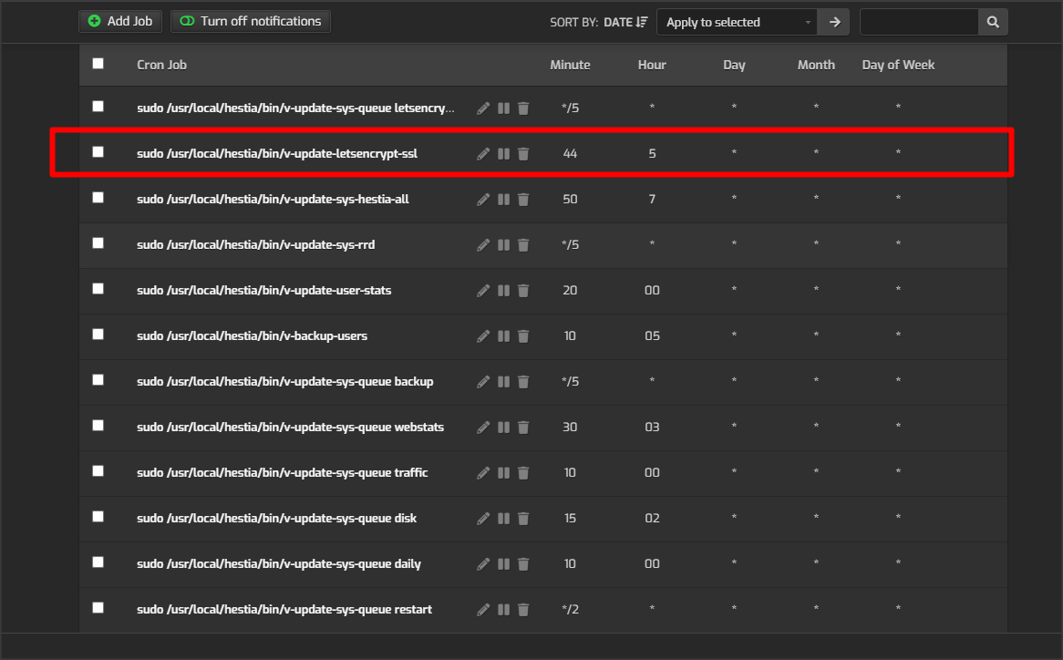

your certificate expired 2 days ago. Can you run v-update-letsencrypt-ssl and try again?
Also check if you have a cron setup for it.
When executing v-update-letsencrypt-ssl it gives the following error
Error: Let’s Encrypt validation status 400. Details: Unable to update challenge :: authorization must be pending.
If it is created in cron
sudo /usr/local/hestia/bin/v-update-letsencrypt-ssl
