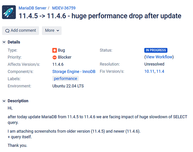

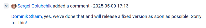

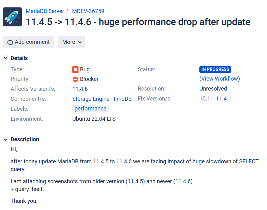

I didn’t find a straight answer but I did see this JIRA ticket opened on May 9th:
And last answer:
So it looks like version 11.4.6 has a bug affecting performance, and since the official repo works for other versions; 10.6, 10.11, 11.8, etc. Maybe they’ve removed 11.4.6 from their repos until a new version is available. I’m just guessing here. :wink:
Seems it’s working again BUT they have removed version 11.4.6 from their repo (right now only versions 11.4.4 and 11.4.5 are available).
