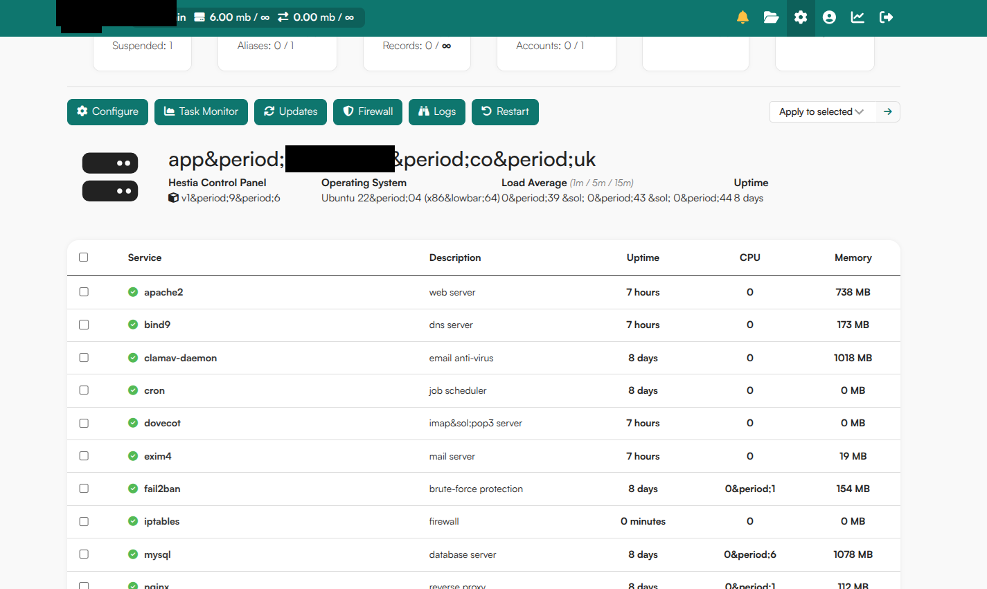

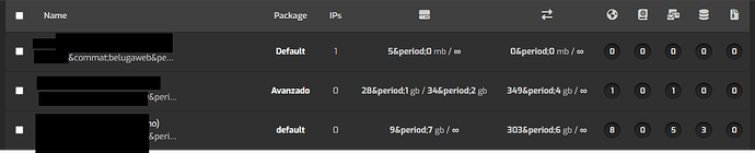

After updating to version 1.9.6, I am experiencing a UI bug where special characters are being rendered as raw HTML entities across the panel instead of their actual symbols.
For example, dots show up as . and the equals sign shows up as =.
While this is mostly a visual annoyance in the domain/user lists, it completely breaks the “Login as user” (SSO) button from the admin account. The autogenerated URL contains = instead of = (e.g., [``https://panel.mydomain.com:8585/login/?loginas=myuser&token``](``https://panel.mydomain.com:8585/login/?loginas=myuser&token``)...), which causes the login token to fail and drops the session.

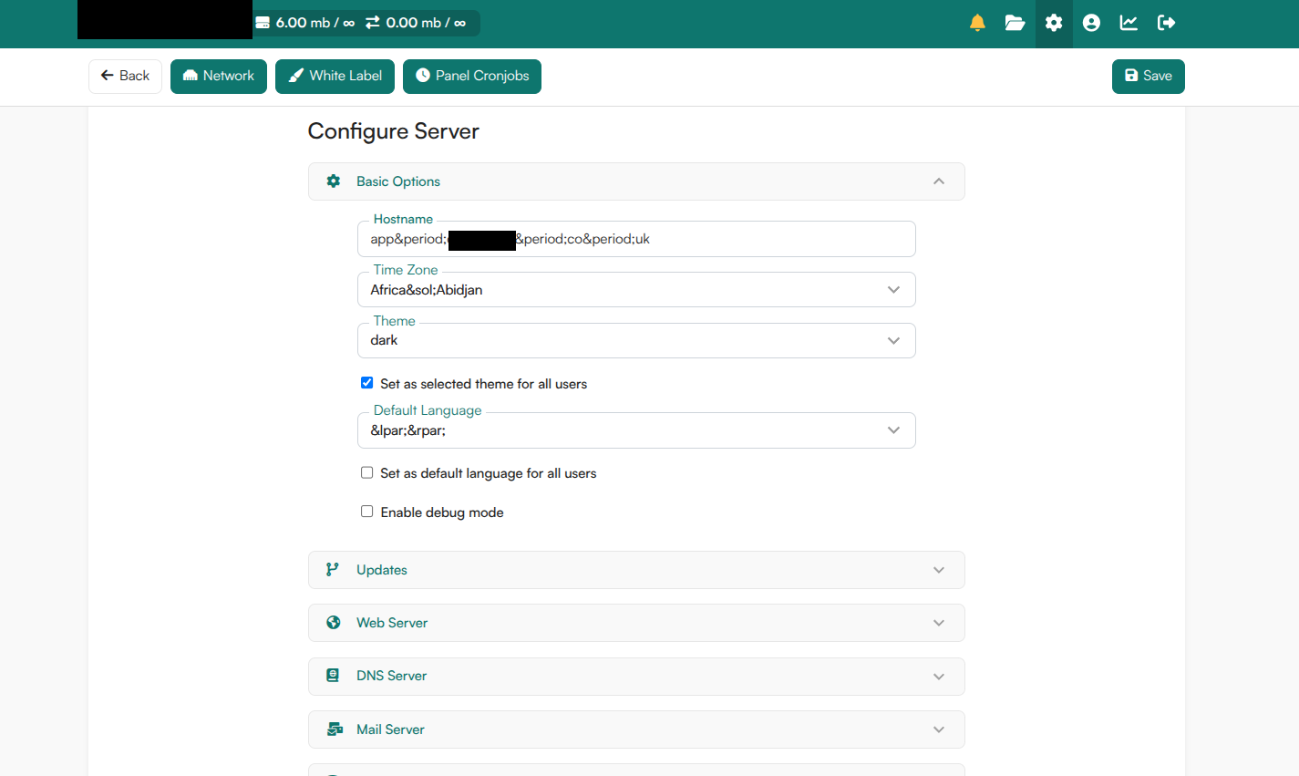

Hi everyone,
I do experience exact same behavior at the moment… using chrome or Firefox same behavior in private browsing. its definitely happening on the server side…
root@hcp:/home/ubuntu# cat -A /etc/default/locale
LANG=C.UTF-8$
Please provide more information: which browser are you using, what extensions do you have installed, what is your browser language, what language is set in Hestia, does the issue also occur in private/incognito mode, and do you see the same behavior when using a different browser?

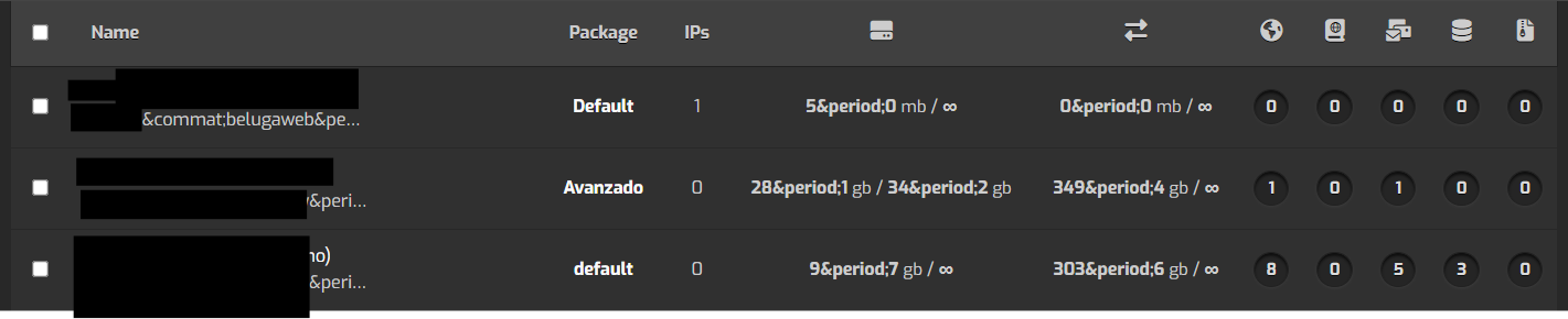

Will attach screenshots below.
I had the problem in both chrome and firefox; did not try incognito; disabling my ublock origin extension did not work.
Hestia language is English (ignore what you see in the screenshot, that was me changing everything to try solve the problem.
VPS with htezner if that helps.

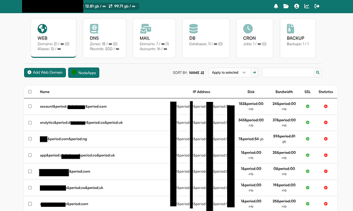

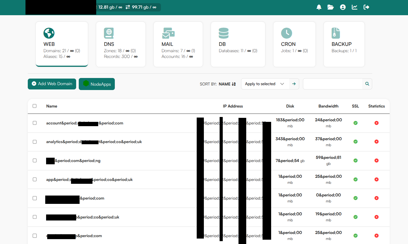

I use hestiacp-pluginable and hcpp-nodeapp for NodeJs, and Max-theme custom theme. Disabling the theme did not help.
Only thing that worked was removing ENT_HTML5 from line 43.
The screenshots of the problem.
I’ve installed hestiacp-pluginable, hcpp-nodeapp and MaxTheme and all works fine on my end.
I see you are using Ubuntu 22.04, I’ll try that OS version tomorrow.
I’ve tested it again and the problem is with hestiacp-pluginable.
Yesterday I didn’t reboot the server, but today, just after installing the plugin and rebooting, the problem appeared. The plugin is modifying the Hestia pages. This issue is unrelated to Hestia, so I won’t investigate it further. You should contact the plugin creator to check the issue.
