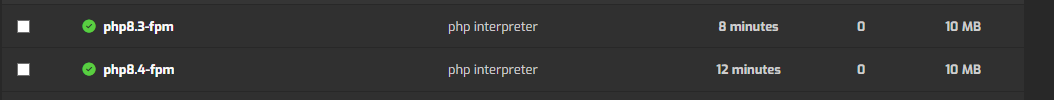

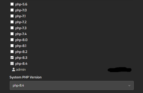

Another strangeness is that there is a conflict due to icecast2 which is located on Port 8000, although in fact it is loaded with one web page, which is not connected with Hestiacp…
It seems to me more and more that the solution to the problem can be a fresh installation of a Web server and setting up with 0. Over the 4-5 years of the server existence, apparently the application of many problems that are easier to delete all at once than to find out bit by bit of what exactly the problem is the problem :sweat_smile:
This & the rest of apache errors are either due to you using an old roundcube, or the roundcube seems to be conflicting with some other packages. Suggest upgrade the roundcude: How to Safely Upgrade Roundcube to 1.6.11 on HestiaCP (Security Fix) & Last apt upgrade of roundcube broke it!
Agreed, seems to me as well (localhost failing too). Maybe due to mysql/mariadb as well being offline. Check that once.
Cannot agree more. My current installation is around 1+ year old, and with loads of breaking changes due to the packages in play, I too feel, I will very soon have to do a fresh installation. Only trouble is, me having 80+GB of data, and the pain of setting up the stuff, which can kill 2 days and cause back pain too. lols
yup, I’ll try to fix everything with a soft method, finding out the reasons for the problems, later I will unsubscribe what I did. Or I will make a clean installation… In my case, there is not so much data, because I mainly lead the site format - notes \ blog, but still restoration even from backup and bringing the site to a completely finished level - this is also a certain problem in my opinion
At the time of the tests, a new version of HestiaCP was obtained, which synchronized the PHP of the site and control panels on version 8.3, when the PHP 8.4 version changes, the error remained. I conclude: it was not possible to solve the problem with a simple method, as a result I reinstalled hestiacp on Debian 12. It seems that after many years of update a control panel, and are packages with their configures, there was too much conflict in configuration files…
